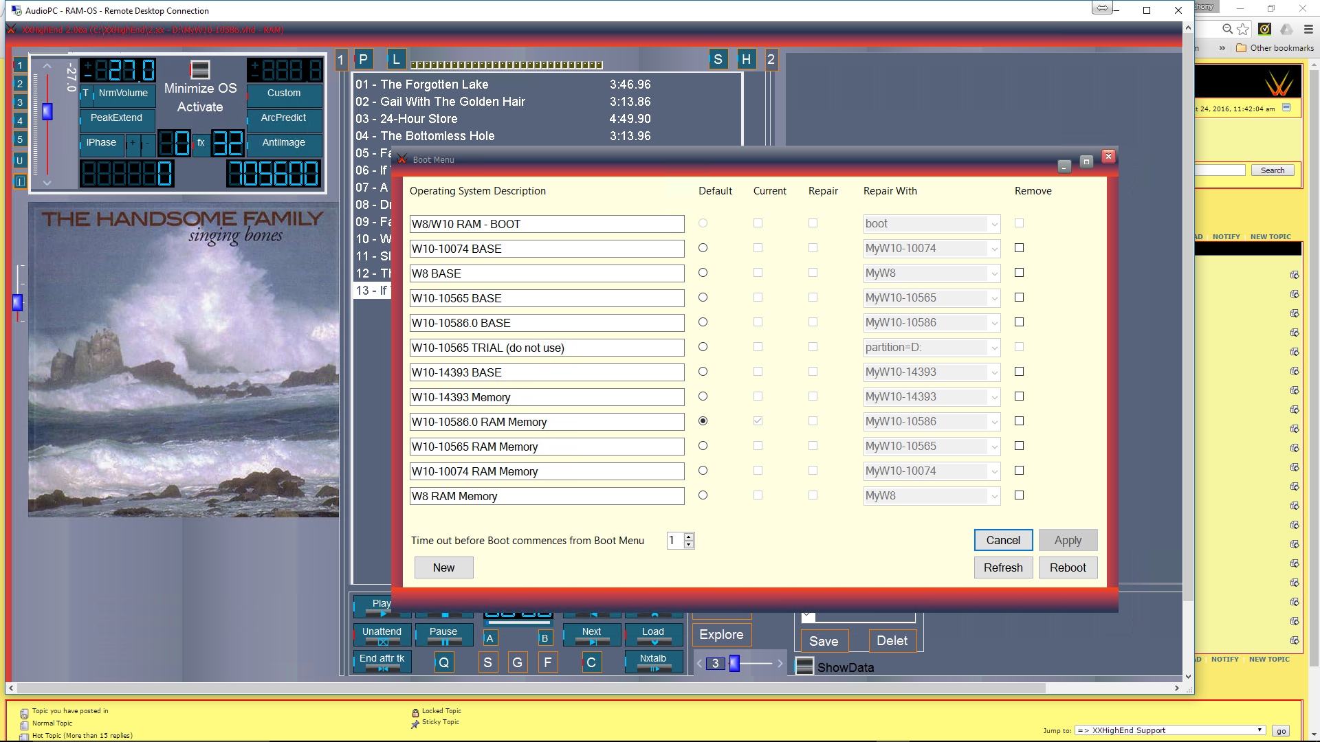

Showing a screenshot of the Boot Menu of XXHighEnd is a good starting point (for me).

I will try to get a screenshot of the boot menu from XXHE now.  It will take a little while to set everything up but hopefully you will see that I am starting by then and we can get things fixed.
« Reply #1 on: August 24, 2016, 11:56:59 am »
Here is the screenshot:
« Reply #2 on: August 24, 2016, 06:08:57 pm »
Hi Anthony,
you got me quite confused now.
W10-14393 is not available in the boot menu at computer startup at all.
While you just showed it ?
So did you now add it, or was your text incorrect ?
If you just added it, then you will also be able to boot into it (this is besides the further issues for the other OSes, but we'll solve that later).
Anyway, now I even the more don't know what happened ...
Edit : I think you meant : when looking at the normal monitor at bootup. Err ... the problem you can have with that to begin with, is that the boot menu now is too large to show all and it shows one or two things of a next page only. But see the tiny arrow next to the list of one or two).
