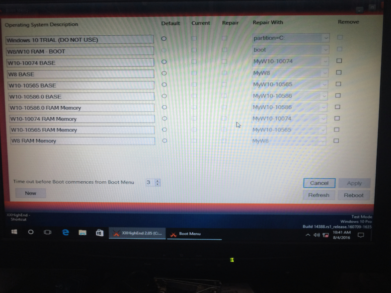

Hi Peter ea,
I've recently begun trying to take full advantage of the RAM OS disk capabilities. That is I've been booting into 10586RAM from the WIN10 TRIAL (DON'T USE) version 14333 and nothing more.

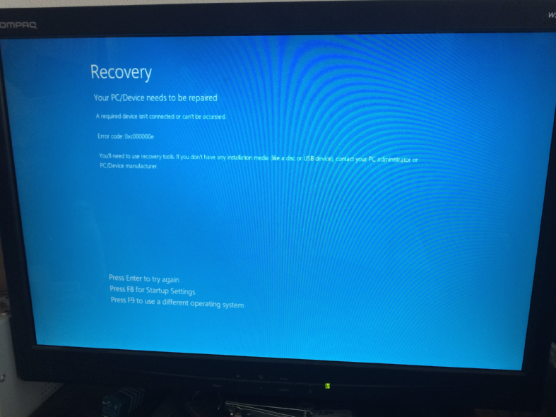

Now I am ready for MIN-OS in RAM and to achieve that I need to boot the 10586 BASE into MIN-OS. However for some strange reason I always end up back in the 14333 TRIAL version. When I try to boot into 10074 BASE I even run into an error.
I've added several screenfotos to illustrate this behavior and tried to give the pictures purposeful names.

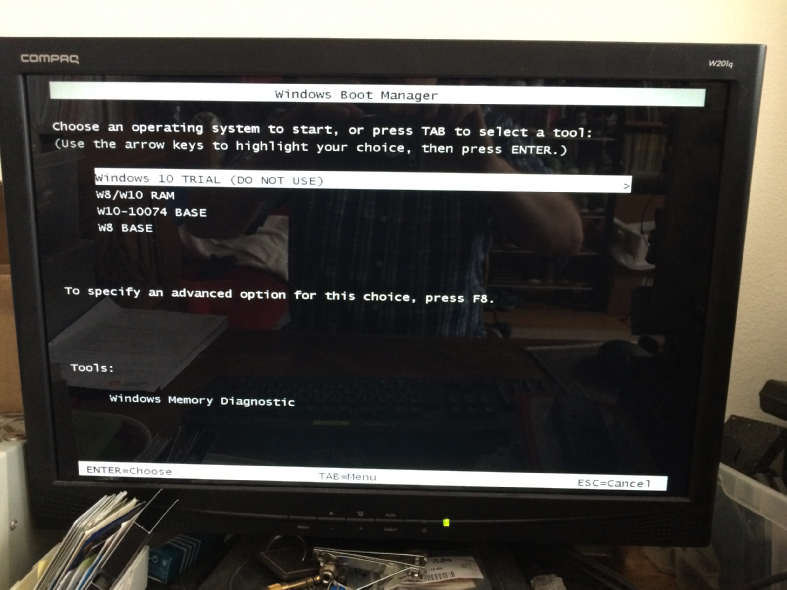

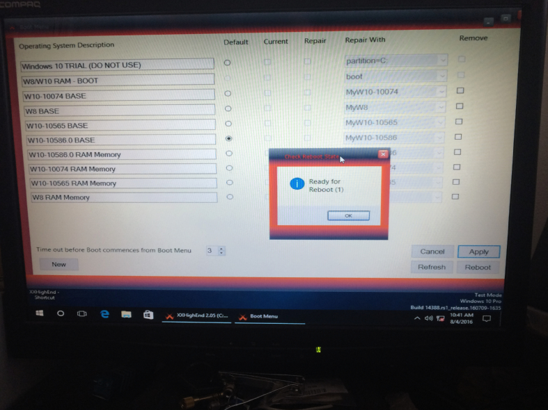

As you can see the bootmenu of the reboot does NOT contain the 10586 BASE version that was chosen in XX before the reboot.
Does anyone recognize this behavior and what can I do about it?
regards, Coen

« Reply #3 on: August 18, 2016, 09:54:47 am »
Now let's see ...
(wacko)
To start with the last (blue) screen ... that is because that OS has expired. Set the system date to Sept. 2, 2015 for that. Then this will work.
Now for the real stuff ...

« Reply #12 on: August 19, 2016, 09:48:47 am »
Hi again Coen,
I can see what is wrong in there and I can't tell how it happened. But some OS quirk.
I think we can solve it like this :
1. Boot into the 14388 (the one named "W10" by you) (you will be in that one anyway)
2. Go into XX's Boot Menu (Stop-RightClick - Boot Into).
3. Tick the checkbox in the Remove Column of W10-10565 BASE.
4. Do the same for W10-10586.0 BASE.
5. Click Apply.
6. Click Refresh.
7. Click New (also see screenshot below).
8. For Name enter W10-10565 BASE.
9. Drop down the field to the right of it and pick MyW10-10565.vhd.
10. Untick the RAM checkbox.
11. Click Apply.
12. Click Refresh and check whether your newly added W10 10565 BASE is there again.
13. Repeat steps 7 u/i 12 for W10 10586.0 BASE.
All good ?
Then boot into W10 10586.0 BASE (don't forget to click Apply after the selection of the OS). It should work again.
