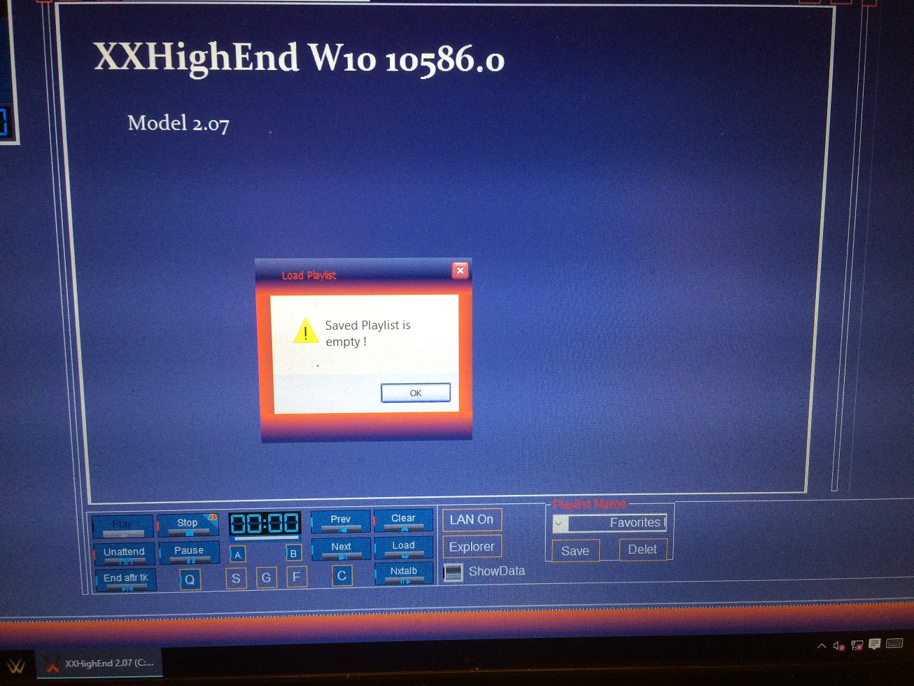

Yesterday evening when I was booting the OS into RAM the boot sequence stopped and asked for the password (XX) which has never happened before. Rather than inputting the password I pressed the reset button, thinking that it wasn't normal to have to input the password. The system rebooted fine and booted properly into the audio PC's desktop. However, when I went to select tracks from a saved playlist I got an error message saying that the playlist was empty. The message appeared with every playlist I selected. I then checked the XXDATA file on the "C" drive  and all of my playlists appeared to be in tact with all tracks present; they were not in fact empty. Then I made an error: after copy/pasting the XXDATA file on the C drive to a backup external drive I then reset the location of the DATA file in XXHighend settings to the C drive.  Afterward I  had a vague feeling that one should not do this....and this did not fix the problem. As before, all of my playlists, when selected, get the error message that they are empty, but they appear to be fine with all tracks there when I open the file on the C drive in explorer. Do I now need to reinstall my 5086 backup and start over or is there an easier solution?

Because I tried to reset my DATA folder, as described in first post, my DATA folder in XX now looks like this \C:DATA\.
Though all of my playlist names (not tracks) appear when I select the Playlist Names dialogue box, lower right in below screen shot,  when I select, for example, "Favorites" no tracks load. All I get is this error message:
I am sorry but I don't even know what "reset" means in this context.
And I understand about the \C:\DATA" (first \ surely looks wrong), so why not just change that (to begin with).
