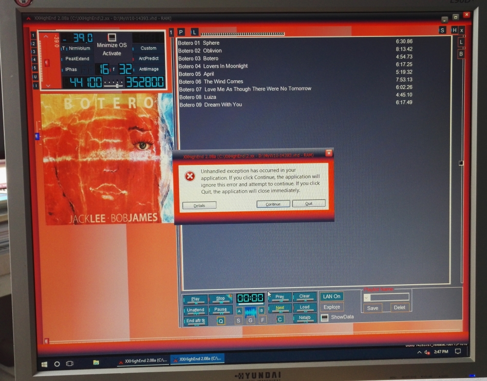

following problem - XXH stops after each song in the "attended mode".
Message pops up -> see picture.
I'm using no tablet, still playing from a PC.

« Reply #2 on: September 29, 2017, 06:50:15 pm »
my info was not complete, sorry
and by clicking NEXT
the
Message pops up -> see picture above.

« Reply #4 on: September 29, 2017, 08:20:14 pm »
Funny operation results here.
It's the "Logging Activities" command.
Process ON -> everything normal
Logging OFF - > see pictures
« Reply #5 on: October 01, 2017, 12:06:25 pm »
Thank you for that additional data, Joachim. Quite crucial !
So yes, with logging Off I can mimick the situation. In itself not so nice, because I need the logging so see what happens ...
Will keep you posted !
