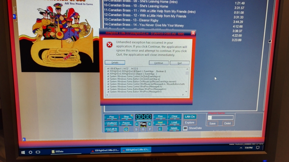

following problem - XXH stops after each song in the "attended mode".
Message pops up -> see picture.
I'm using no tablet, still playing from a PC.

« Reply #1 on: September 29, 2017, 06:04:51 pm »
Hi Joachim,
Can you please do this :
- Switch on logging.
- Quit and restart XXHighEnd.
- Let this problem occur.
- With that message you showed still on-screen, grab the latest XX- log file and keep that safe.
- Click away that error message and again grab that same log file (after a few seconds, do not click anything else - the log file will contain additional data now).
- Attach the log file to a post in here.
Thank you !

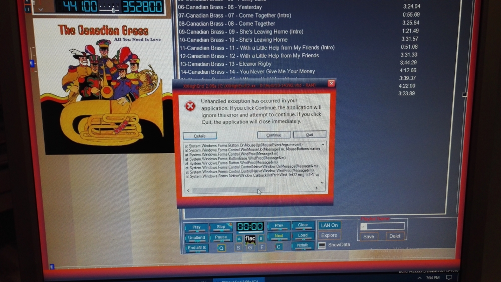

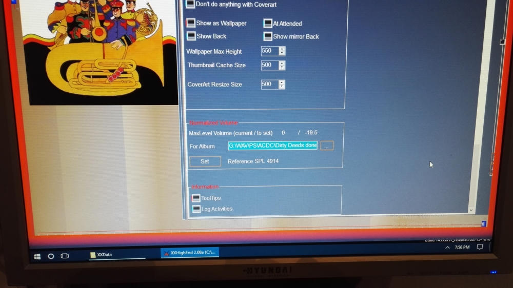

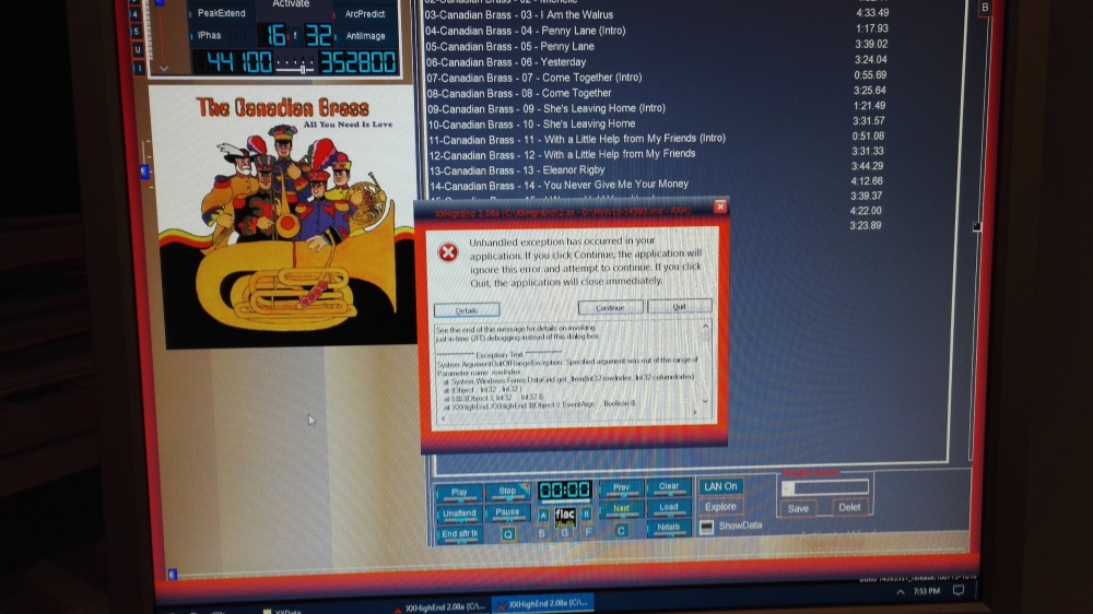

« Reply #4 on: September 29, 2017, 08:20:14 pm »
Funny operation results here.
It's the "Logging Activities" command.
Process ON -> everything normal
Logging OFF - > see pictures
« Reply #5 on: October 01, 2017, 12:06:25 pm »
Thank you for that additional data, Joachim. Quite crucial !
So yes, with logging Off I can mimick the situation. In itself not so nice, because I need the logging so see what happens ...
Will keep you posted !
« Reply #6 on: October 01, 2017, 02:55:11 pm »
This is solved in the newly uploaded 2.08d.
