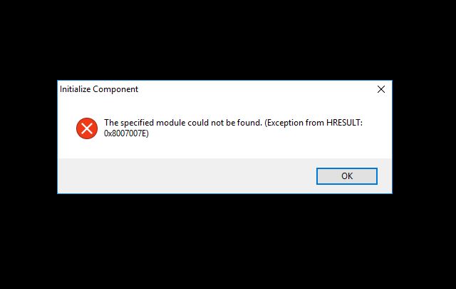

Thanks for replies nik.d and Ramesh and the Net 3.5 was all correct. UAC is off. I get this message on the screen.
The specified module could not be found. Exception from HRESULT:0x8007007E

If you remember our last e-mail corresp. - I had this very same error on my AudioPC (lost XXHE licence) under normal OS. Think it is not UAC (set to Low-Never Notify position) but rather something with disabling Win Defender and some functions in Action Center - I tried to stop security messages popping up every now and then Happy

Hi I downloaded XXh to C driver folder. I do run windows defender on this computer and UAC shut off as normal. This is not a dedicated audio computer. I have Net 3.5 working. Then hit XXh.exe and a hot key is setup then the warning message comes up without changing anything in this computer. I havn't loaded XXh into an OS since Ram OS.

« Reply #12 on: May 25, 2018, 08:23:57 am »
Its not worth the trouble to make it do anything less I guess.
Robert, that could be correct.
But that doesn't prohibit that it should normally run in a random "normal" OS. But as this is "updated" Windows 10, well ... now I don't know.
What about coughing up the newest logfile starting with XX when this message is on-screen ?

« Reply #14 on: May 25, 2018, 12:56:16 pm »
Hi Robert,
Yes, there are a lot of complaints, lately.
Question : Why do you not prevent Updates via XXHighEnd, though in Normal OS etc. ? I'd reckon this just works ?
Watch out please : if this fails, it will be because of Defender blocking some registry change I apply. Please let me know if you recognise that this indeed is the case. If so, I have a version for you which will avoid this issue (while Defender can keep on running).
