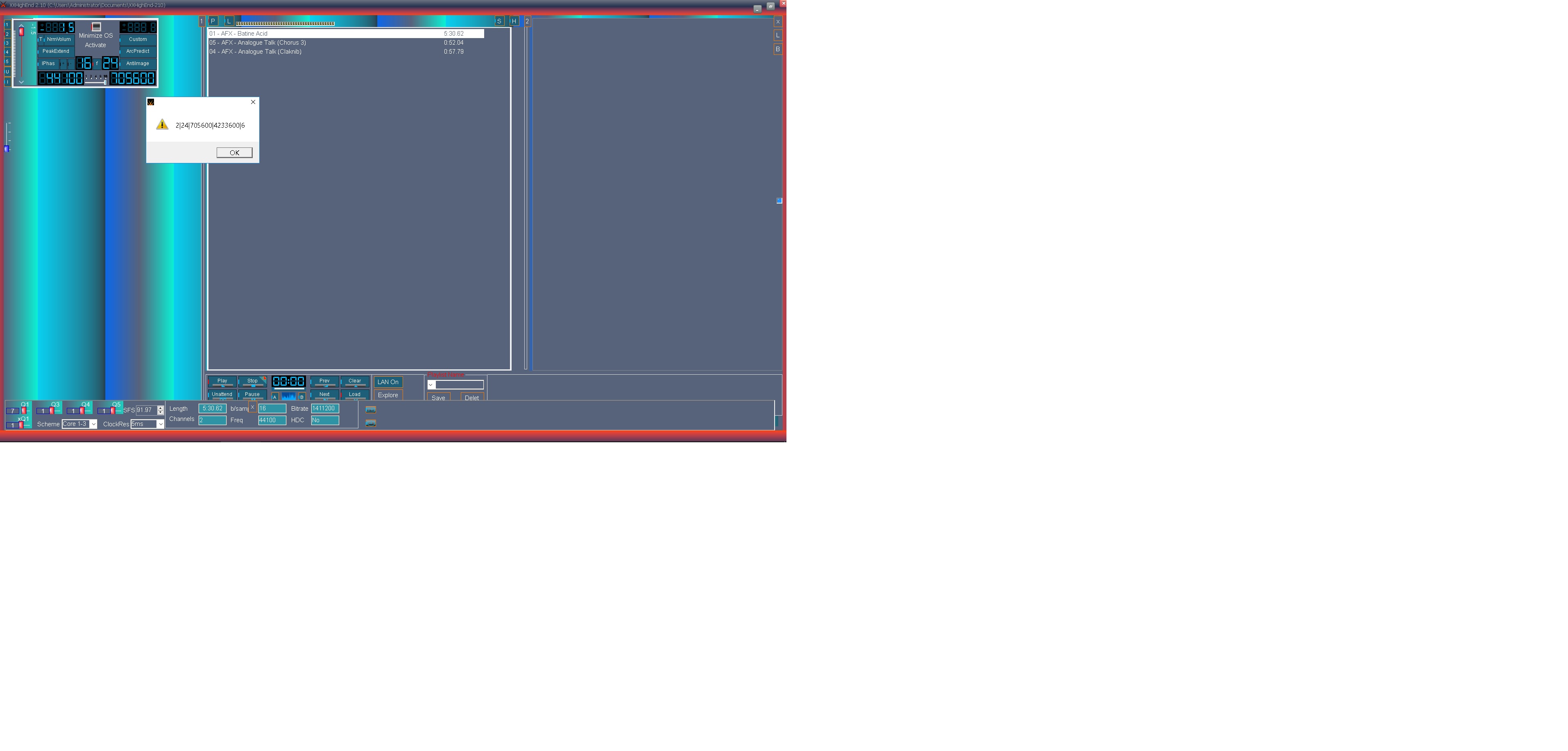

Btw, it should be so that you get one or two more error messages, one of them showing a sequence of numbers. Am I right ? if so, can you give me a screencopy of that ?

you are correct about number error, screenshot is attached.
