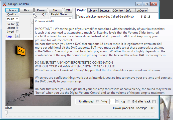

« Reply #8 on: March 03, 2008, 07:44:27 pm »
For now, and for others KEEP ON KEEPING THIS IN MIND !
... and maybe for more reasons than indicated here :

« Reply #10 on: March 03, 2008, 08:12:13 pm »
It is strongly advised to not use your system without a preamp (or the pre-amp at max volume for that matter) if you or your speakers won't be able to handle a situation that e.g. the file contains wrongly formatted data or otherwise - because of which cracks may emerge with an energy beyond imagination.
I added this text to the Release Notes on each of the versions that support the Digital Volume. The least I could do. scare
To emphasize the potential danger : you may have heard of the Densen CD. This CD contains a special track that "demagnetizes" the equipment. The track contains rather rubbish tones. Throughout times I smoked both of my Infinity R90 tweeters TWICE by playing this track too loud. "Too loud" meant : the volume at 10-to while normal music played at 15-past easily or at full for that matter.
It's the harmonics which are dangerous, and the cracks as can be experienced are full of squares, producing those harmonics.
Ever heard of UDIAL ? this is a kind of SRC test file and there too 19KHz harmonics (inaudible) exist. That smokes speakers easily.
