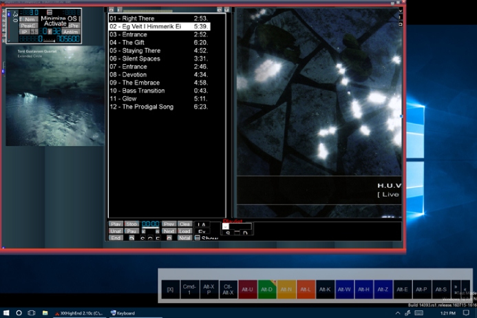

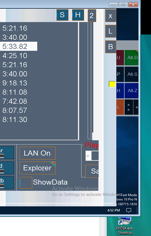

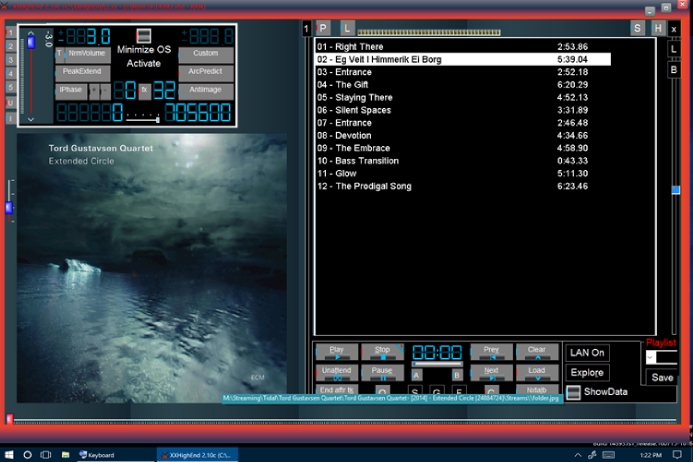

Hopefully this is a simple one to fix.  Before I press play the screen of my tablet which is RDC'd into the MusicServer looks like Before.jpg, after playing and return to XXHE GUI it looks like After.jpg, which is obviously different, then if I exit XXHE and then restart it, it looks like After Restart.jpg.  All three are different.
