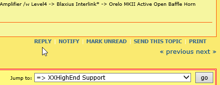

Btw, you can use the Reply link to add posts to this topic. See little screenshot below. It's in the bottom-right corner.
