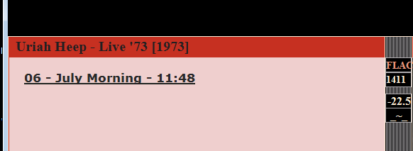

First question would be : what does it mean "crashing" ? I mean, usually nothing ends or quits without an error message of some sort. Once exception in this case : being in Demo mode. So are you sure the program is out of Demo Mode ?
Regarding that, please carefully read the instructions in the Activation Email you received - this is about the Red Bordered Coverart (or Yellow when still in Demo mode).
So can it be that ? (also see picture below for the Red border)
If not, any messages from the program to share ?
And just to be sure : I don't recognize any crashing at all. The program is really super stable regarding this.
