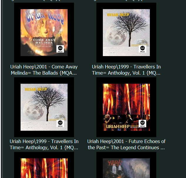

Hi Colin,
The number of hours I worked on this (last early this morning Happy) starts to be countless. The solution (as per your proposal) seems to easy, but it is about the recognition of what's what. And per the initial changes I applied last November (yuk) I myself don't even have any indication any more (see below, all show without sampling rate).
In the (impossible) mix is the changes Tidal applied to the search data, but at least that I could finish yesterday. This is how I today *have* to proceed with the MQA stuff, because currently it is completely useless. Plus, I don't want to take it out all together. And oh, what I sure *am* considering is not presenting the MQA16 stuff. As if it does not exist in Tidal. I mean ... *if* I would be able to show the 16 bits separately from the others, I'd still have the issue of what you report about : something is not treating the data as should (because of the illegal situation). Also this all includes the special search facility so you are able to avoid the MQA16 stuff (I half finished that earlier on), but looking at myself ... I would always used that. Thus leave them out all together seems a good solution to me ...
scratching

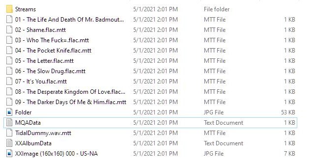

These new unmarked MQA tracks would not play for me unless I unchecked the Decode MQA box. I have now just started deleting all the files on the first page of the folder structure - the MTT, MQA Data,  ect. leaving only the stream folder.
This seems to work without issue now and the bit rate comes up at 24, 48000 and plays like a normal FLAC.

« Reply #14 on: June 04, 2021, 06:57:20 pm »
I just manually delete these files under the Streams folder.
