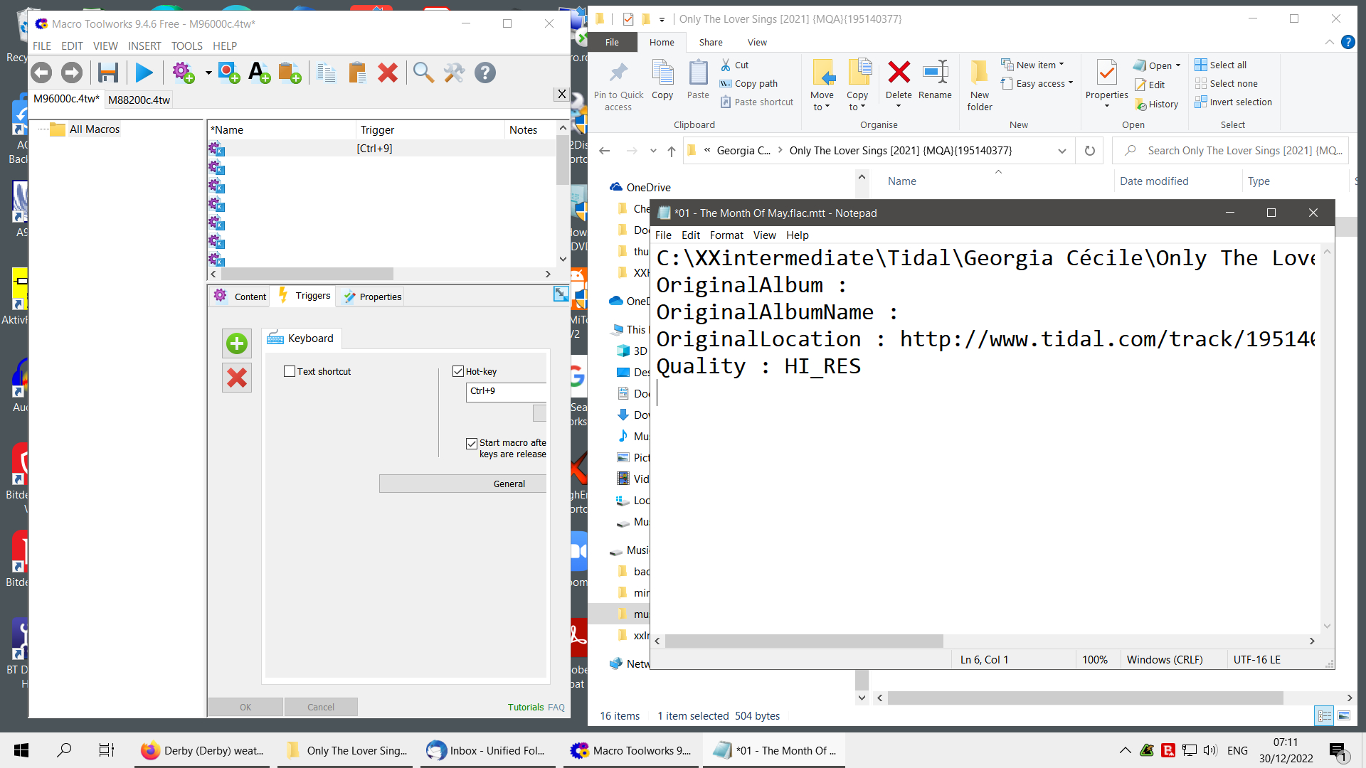

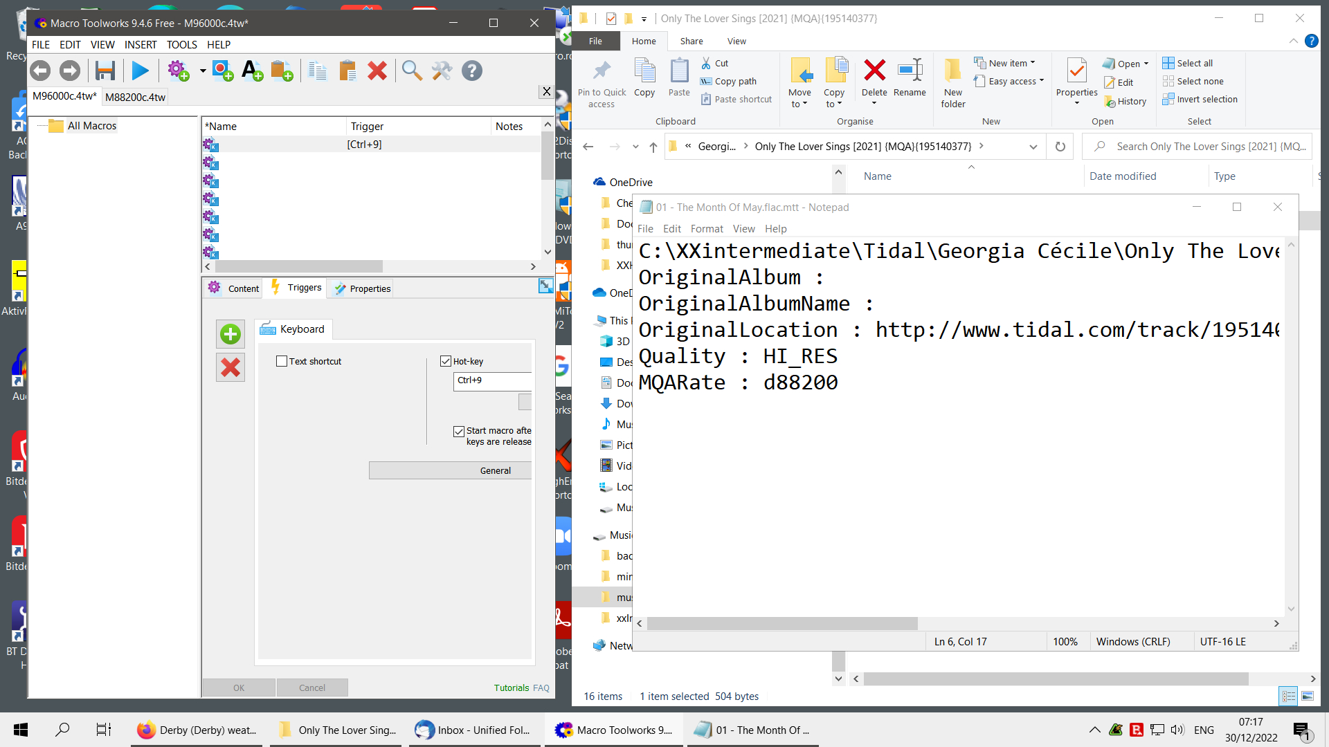

To speed up editing the MTT files I have created 2 macros using Macro Toolworks free edition.
Download and install it:- https://www.pitrinec.com/download
Copy the 2 attached macros to the Toolworks macro folder.
Start Toolworks and open both the macros.
Attached jpeg MQA Macro Start shows what it should look like.
Open the first .MTT file and position cursor below last line of text (as in jpeg).
When you stream a Tidal album note sample rate, the MQARate will be twice this.
If MQARate is already there without a value just highlight it before running the macro.
ctl+8 runs the 88200 macro or ctl+9 runs the 96000 macro.
Result should be like attached jpeg MQA Macro Done.
Close MTT file and repeat for remaining MTT files.
I have streamed a lot of MQA albums and all play well after editing the MQARate. Even 44/16 MQA albums work.
Good Luck & Happy New Year
Colin
