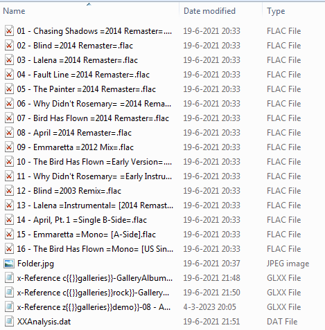

I have been more than busy this week, but ran coincidentally on the albums you see below - the rightmost three.
They don't unfold at all, although the pre-process marked them as MQA anyway (MQA44). They play as 16/44.1, but are of course upsampled like everything. I can see that they are from June 2021 and I will most probably be able to find more what I prepared from that time period.
Point is : these sound just fine to my ears, though special for their era (something like end 60s I'd say). *That* they still sound special is a good sign. It somehow (wants to) tells me that this was not tampered with. And so indeed, there will be some bit (now and then) used for the MQA detection, but that does not disturb (my ears).
Keep in mind : these are not decoded. XXHighEnd just leaves them alone, and this is in the XXHighEnd version you use too (the latest). Where these still can be found - I don't know (I did not look either) but it could be worth trying. But more importantly : I should have a reference by these. IOW, what is the software NOT doing to them and why. Probably today I can not test that (because all what seems fake I skip), BUT I know the dates of these plus I will be able to trace back by date what I all changed since (ahem) April 2021 (latest public version).
So right; I now can search / sort by date for MQA 16/44.1 from around that time (June 2021) and listen to more of them ...
Colin, again thank you very much for the spent effort. I will try to make that fruitful.

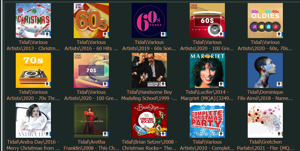

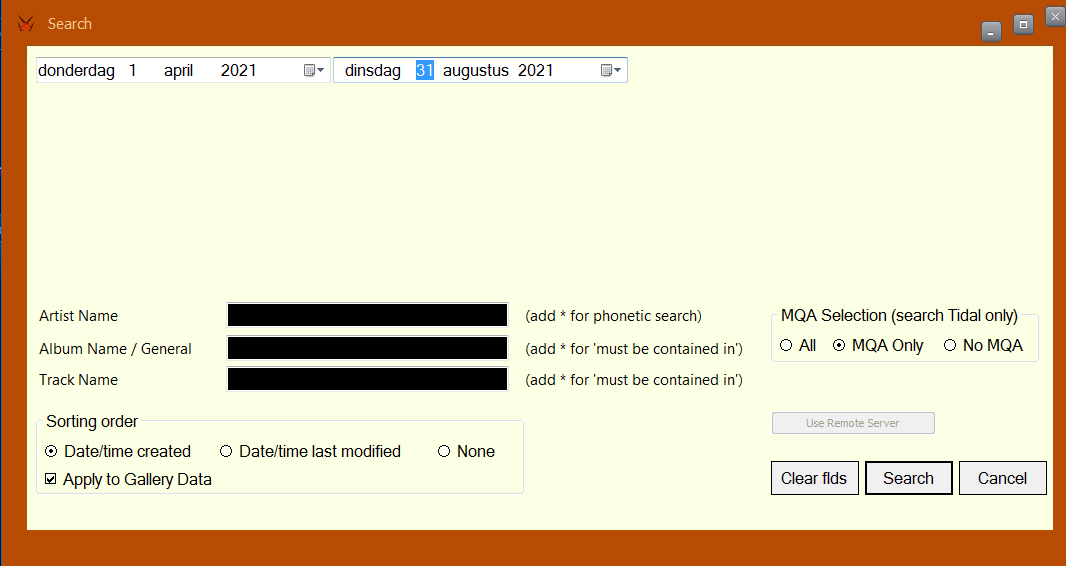

« Reply #22 on: March 10, 2023, 06:50:41 pm »
A limited result ...
When I go 6 months beyond that end date, I have some more (2nd screenshot). Btw, mind the blue icons only (44). But I already know by heart that most I see are 24/44.1. They also don't unfold but they are decoded. This is fine with me and not of my interest today. The interest is : find the software means I must have (had !) in there to leave the 16/44.1's alone for decoding. The the Deep Purple ones.

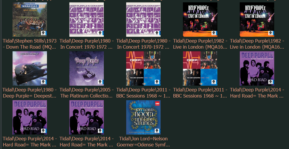

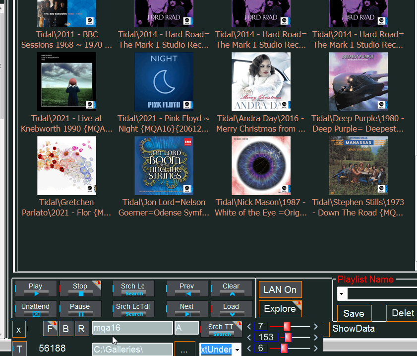

« Reply #24 on: March 12, 2023, 08:18:19 pm »
So I just obtained this one and a couple more. I see that I denote these "formally" MQA16 (see in the title bar below). This does not unfold or act strange or anything; it is just not dealt with by the MQA decoder. Also see the 1411 kbits/sec in the top-middle.
Does it sound optimally ? I don't know - I didn't know it. And because I didn't have it plus I like to have it "all" (from Gruppo Sportivo) I am a happy camper. It better had been 100% untampered with, but alas.
Please notice that there are also "opportunities" so to speak; I mean, this album was not there at Tidal a while ago. So maybe because of MQA it now is ?

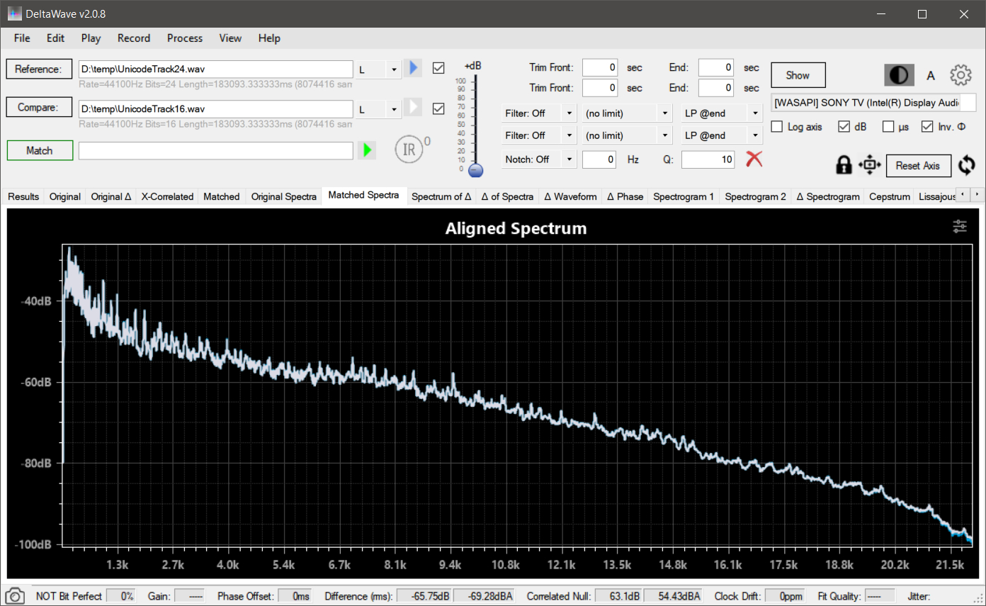

« Reply #28 on: March 14, 2023, 06:07:45 pm »
Hi Peter
Something happens when decoding MQA16, attached is 1st track of the Gruppo Sportiv album and it shows decoding to 24bit and lower noise above about 20KHz
Good album
Colin
