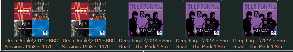

« Reply #21 on: March 10, 2023, 06:31:40 pm »
I have been more than busy this week, but ran coincidentally on the albums you see below - the rightmost three.
They don't unfold at all, although the pre-process marked them as MQA anyway (MQA44). They play as 16/44.1, but are of course upsampled like everything. I can see that they are from June 2021 and I will most probably be able to find more what I prepared from that time period.
Point is : these sound just fine to my ears, though special for their era (something like end 60s I'd say). *That* they still sound special is a good sign. It somehow (wants to) tells me that this was not tampered with. And so indeed, there will be some bit (now and then) used for the MQA detection, but that does not disturb (my ears).
Keep in mind : these are not decoded. XXHighEnd just leaves them alone, and this is in the XXHighEnd version you use too (the latest). Where these still can be found - I don't know (I did not look either) but it could be worth trying. But more importantly : I should have a reference by these. IOW, what is the software NOT doing to them and why. Probably today I can not test that (because all what seems fake I skip), BUT I know the dates of these plus I will be able to trace back by date what I all changed since (ahem) April 2021 (latest public version).
So right; I now can search / sort by date for MQA 16/44.1 from around that time (June 2021) and listen to more of them ...
Colin, again thank you very much for the spent effort. I will try to make that fruitful.

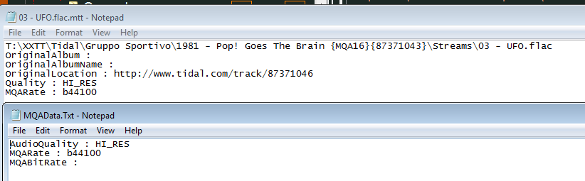

« Reply #24 on: March 12, 2023, 08:18:19 pm »
So I just obtained this one and a couple more. I see that I denote these "formally" MQA16 (see in the title bar below). This does not unfold or act strange or anything; it is just not dealt with by the MQA decoder. Also see the 1411 kbits/sec in the top-middle.
Does it sound optimally ? I don't know - I didn't know it. And because I didn't have it plus I like to have it "all" (from Gruppo Sportivo) I am a happy camper. It better had been 100% untampered with, but alas.

« Reply #25 on: March 12, 2023, 08:34:34 pm »
Addendum :
Notice that I use 2.11 just like you for the Audio PC. But it is the updated version on the Music Server PC that will cause this.
Maybe the below is telling ?
Stupid thing is that I now don't know what I am "skipping" (don't show) as such. So XXHighEnd just finds these and deals with them exactly how I would want. Or maybe a year ago I thought to go skip them because worthless ? ... But I did not do that ? and now insights change and I am even happy with that because I/we can choose (to skip the MQA16 denotes ones) ?
PS: The Quality : HI_RES is not correct of course. But this is officially in the data provided by Tidal - just saying ...

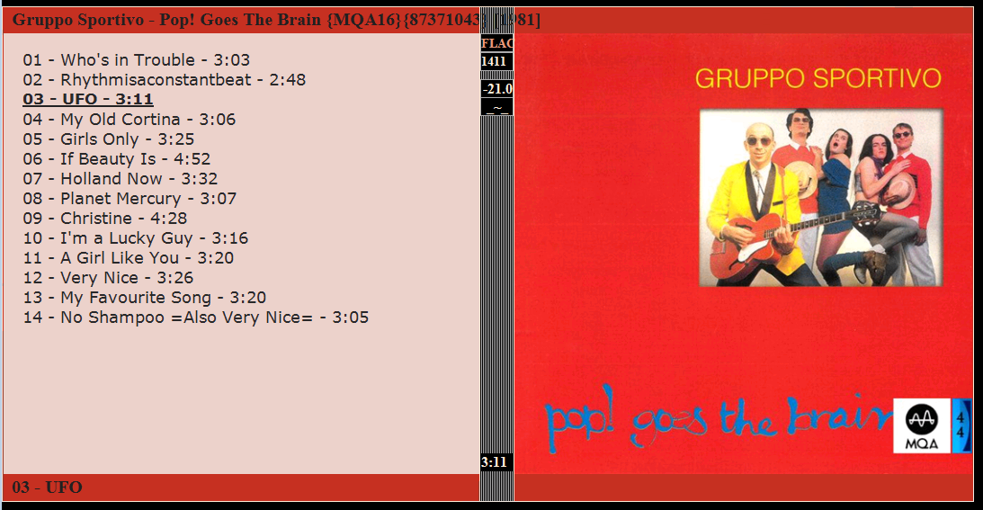

« Reply #27 on: March 14, 2023, 05:07:44 pm »
Hi Colin,
Maybe it wasn't entirely clear : those MQAs are 16 bits and 44.1. There can't be anything in there to do with. And thus it is good that nothing is done with it because it would be illegal if something *is* done with it (like Roon and Tidal Player do).
You can always look in the middle-top of the CD cover (the one shown during playback). If that shows 1411 it is 16 bits and 44.1 KHz.
If it is 24 bits withoutunfold (your last textual example I think) it will show 1411/16*24 = 2116 (2117).
Is it 24 bits unfolded, then 2116 * 2 = 4232. More is not possible because more never unfolds (the made up story/lie). This doesn't prevent that it can be upsampled from there. This shows in the left pane in the XXHighEnd gui. There can also show the native 24/192 if it would be that. Etc. ...
Maybe superfluously : the 24 bits MQA's which don't unfold exist from almost the beginning. Electrified from Boris Blank is such an example (the 24/44.1 version - a 24/96 version exists too). Thus that is an example which will show 2216 in the top of the Coverart. Let's say that these are "deblurred" just the same, but not HiRes.
The ones I show in my last post(s) are 16/44.1 and whether deblurred or not, I thus don't do anything with them because there is nothing to do**. In my version that is ! And they are denoted MQA16. Ad oh, since I now know that (recall it), I now see that I can look for them by searching for MQA16 - see below above the mouse pointer.
**): Deblurring and such does not happen on your side; it happens at the encoding server-side somewhere (ehh, if at all). The decoding is only for the unfolding. Unfolding means : expanding to Hires - which requires 24 bits first.

coliny
Posts: 184
« Reply #28 on: March 14, 2023, 06:07:45 pm »
Hi Peter
Something happens when decoding MQA16, attached is 1st track of the Gruppo Sportiv album and it shows decoding to 24bit and lower noise above about 20KHz
Good album
Colin
