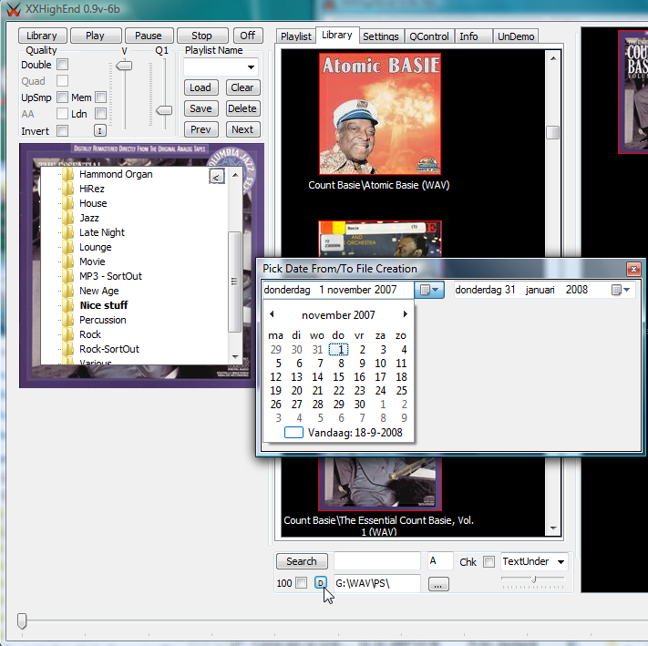

Hi there Down Under,
If you look at the first picture below, the mouse pointer points to this little "D". Clicking that brings up the Date Picker.
I selected from Nov. 1 2007 u/i Jan 31 2008;

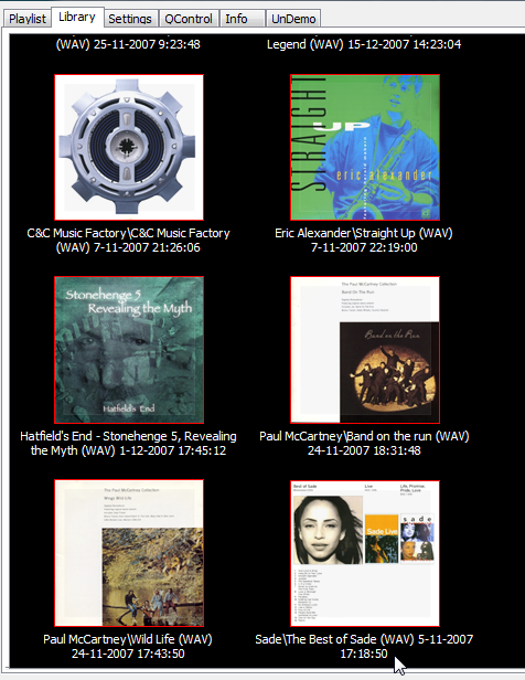

The second picture shows (a part of) what I ripped in that period. You can see the exact dates and times doing that.
FLACing doesn't change those "rip dates".
So, it is not sorting on that date, but you can select on the period anyway.

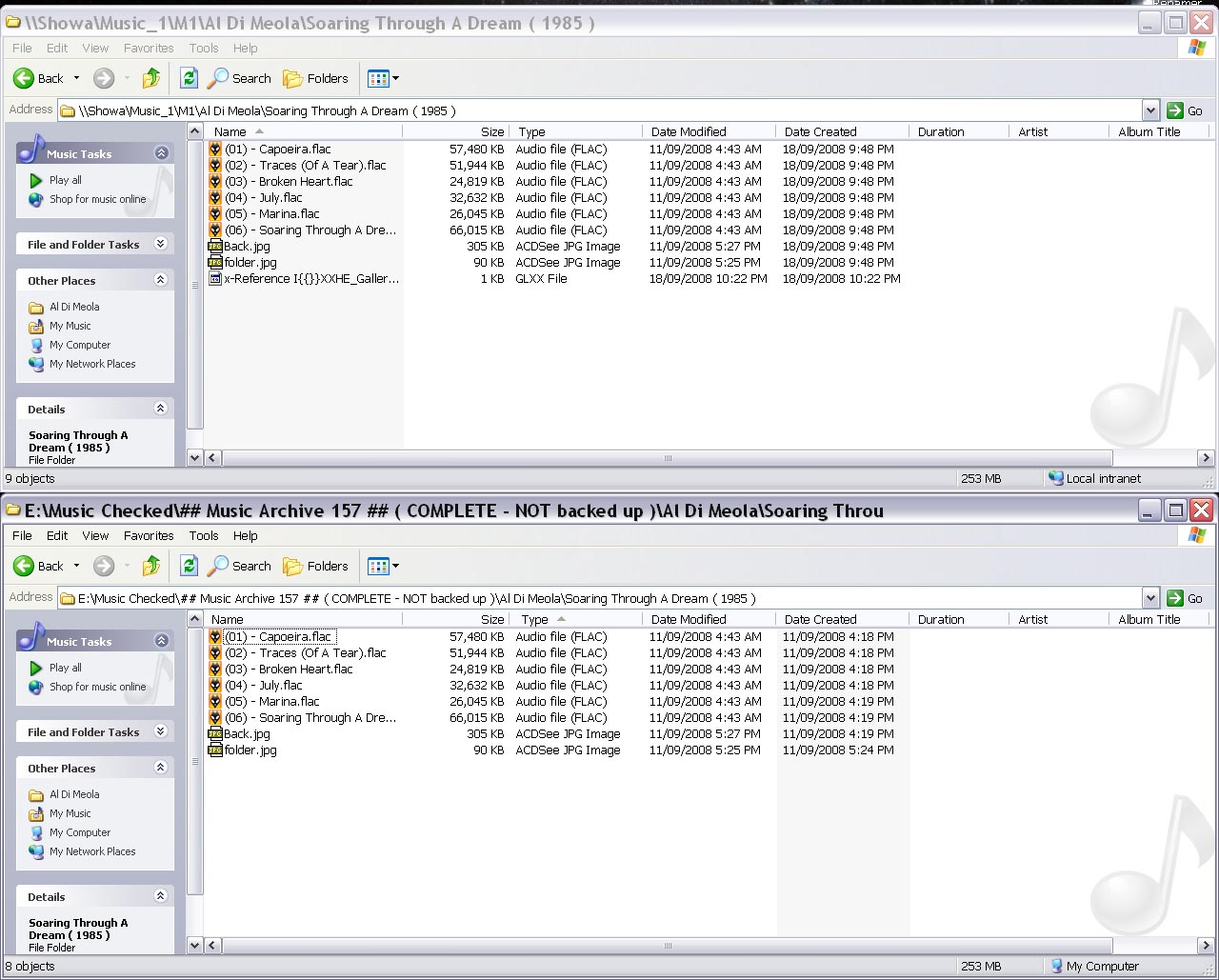

« Reply #6 on: September 19, 2008, 12:20:13 pm »
... that this is about the date creation of the original.
ah ha! I think this is where things become unstuck .. well .. from my perspective anyway .. LOL.
In the screen capture below there are Explorer views of the files as they exist on my study PC ( lower section ) and the equivalent as they exist on my HTPC. Note the 'date created' column differences. Now, I would have expected that if you put in a Date Picker range of 18th - 19th they would have been picked up, but they don't, you need to extend that range to the 11th to get them, and that's my issue.
Is this any more helpful?

« Reply #7 on: September 19, 2008, 03:31:18 pm »
Yes, I think I understand now what you want (and why you need it).
I was about to make a general sort routine anyway, and this is just another base for the sorting.

« Reply #12 on: September 19, 2008, 07:02:40 pm »
And a confession for your morning cup of tea : I am using the "Last Modified" Date/Time. *Not* the "File Creation" time. fool
The latter I will add for you now ...
