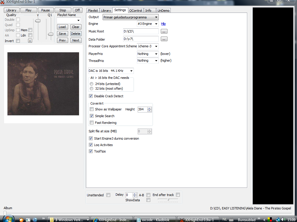

W1 does not work. Right after press play this error comes up. Slider does move and for 1 sec i hear music. right after that nothing. With a new track the same error apears. And the slider moves like there is noting wrong.

Hmm ... In the Settings Area there's a disabled field "Split large files". I assume that's on 2500 ?
Furthermore, are you sure you upgraded all files ? Please look at the date of XXEngine3.exe. It should be from yesterday.

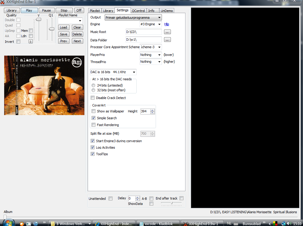

I just checked xxengine3 and that is from the 19e. But now it does play..... When i downloaded w1 and put in the new code there is no problem. see w3 down below. But when i put the new file's in the old map containing the version before this one, than w2 is shown and it will not play.
Strange thing is that where you talk about 2500 in the disabled field there is 0 in pic w2 and 700 in w3.
so w2 did not play
    w3 did play

This is the most weird ...
The 0 (instead of 2500) I already was afraid of (couldn't test this properly), but where the heck the 700 comes from ?? if it weren't that I used 700 at some stage for a default I'd say it's random. But I *did* use 700, and now you have that.
Ok, even with 700 it won't work. You may think so, but it will go wrong at some stage.
I'm afraid I'll have to put up a new version ...
Thanks Gerard.
PS: I think this goes wrong somewhere at answering Yes to "Load previous settings". So, it does that, but obtains 0 because officially the feature is already in there all the way, but doesn't work properly. The default of 2500 (as how it's put in there) is thus overwritten by your "yes" answer.
That still doesn't explain where the 700 comes from, but I guess that's somewhere "hard coded" in the program due to testing.
