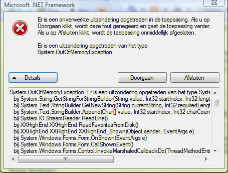

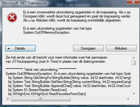

During playback in version 09w-5 i have got a OutOfMemoryException error. After this error XX don't start anymore. Everytime when i start XX it gives this error. Even after a system reboot. Deleting Favorites.txt solves the problem. What caused this problem?
Johan

« Reply #1 on: December 22, 2008, 12:46:13 am »
Is this different from what you had before ? (when you were "able" to create a Favorites file of 370MB !)
It looks like the same problem.
Can it be that somthing took longer than you wanted, and you clicked a Favorites link again while another one was pending, and that that initiated the real problem (things get in a loop and the file grows and grows) ?
« Reply #2 on: December 22, 2008, 07:27:28 pm »
It's the same error. I had the idea that it was caused by starting two different versions of XX at the same time. But i'll think this is not what caused it.
. .....and you clicked a Favorites link again while another one was pending......
How do i click a favorite link? Do you mean selecting a record in the Library area?

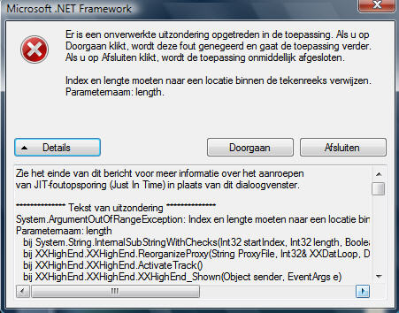

« Reply #8 on: January 21, 2009, 08:40:29 pm »
Can't you find out just when it happens ?
Almost every day now i have this OutOfMemoryException error again during unattended playback in version 09-w8 . Deleting the favorite.text file doesn't help anymore. Starting XX gives this error again.
XXengine3.exe is still active in the taskmanager
I need to reinstall XX again in a new directory. I hope you have a solution for me PLEASE!
See logfile as attachement
* XX-20090121-190630.log (1.42 KB - downloaded 549 times.)
« Reply #9 on: January 21, 2009, 10:06:03 pm »
Hi Johan,
I don't see any Out of memory exception ??
If you can repeat this for Bill Frisell, what happens if you throw out the picture(s) you have on him ?
Note that you well can have an Out of memory error, but it is not what you showed.
Also, please try to tell exactly what you did, because this must be importand since you seem to be the only one having this ?
When you can't get out of the loop, you can try to delete !Played.dat from your XX folder. It can't harm to delete this.
A !CurrentlyPlaying.PLXX could also be a cause. You can delete that too (at emergencies).
If you are going to tell me the sequence of things, please also try to indicate how many seconds are between two actions of yours. Example :
Selected album ABC from the Gallery, nothing seems to happen, and I pressed load again within 5 seconds because nothing seemed to happen.
Then in 4 seonds I pressed Play, because really  nothing seemed to happen anymore.
« Last Edit: January 22, 2009, 08:30:43 am by PeterSt » Logged
« Reply #10 on: January 29, 2009, 10:56:43 pm »
Again an Out of Memory Exception error! This time in version 09w-9b.
What i did:
1 Double click in the library area to select an Album
2 Tracks are direct loaded in the playlist
3 Selecting the play button
4 XX plays in unattended mode
5 After some tracks i get this error.
6 Music keeps playing
7 XX ends with the Wallpaper and do'nt switched back
8 I cannot start XX again.
Deleting the suggested files did not help but deleting favorites.txt helps. I noticed that several times this favorite file is 369.3xx kB big.
How do i influence the size of this file? Has it something to do with this error message?
Johan
« Last Edit: February 02, 2009, 07:29:10 am by PeterSt » Logged
« Reply #11 on: January 30, 2009, 04:17:45 pm »
Hi Johan,
It looks like that this might go wrong as soon as you add a Favorites entry that has a "unicode" charachter in it (and then quit XXHighEnd). Please look below.
That A from Nils Petter etc. (from your file from a while ago) might be really there in your file, or it is not and is something else. Can you please look ?
The rubbish you see beyond it, repeats for 365 MegaByte or so ...
« Reply #12 on: January 31, 2009, 12:02:07 am »
Adding Nils Petter to the Galary has the following effect in favorites.txt:
the first time:
2;D:\Galeries\Canterbury\
4;D:\Galeries\Jazz\
1;D:\Galeries\Jazz\Nils Petter Molvær\
1;I:\Music\Jazz\
second time:
4;D:\Galeries\Jazz\
1;I:\Music\Jazz\
third time:
4;D:\Galeries\Jazz\
1;D:\Galeries\Jazz\Nils Petter Molvær\ wacko
1;I:\Music\Jazz\
As you can see Molvaer becomes stranger and stranger.....
« Reply #13 on: February 01, 2009, 12:01:12 am »
Again this evening an "Out Of Memory Exception error" during unattended playback.
Looking at the Favorite.txt file gives a problem with Nils Petter
1;D:\Galeries\Jazz\Nils Petter MolvÃÃÆâ etc........................................
« Reply #14 on: February 01, 2009, 12:22:45 am »
What a stupid thing this is !
If you know about more examples (or just can create them), please let me know. If not, I can check for this sequence to happen based on that name (the sequence itself is not really repetetive as it seems).
"Adding of Nils Petter Molvaer to Favorites is not allowed - press enter to continue"
Computers ...
