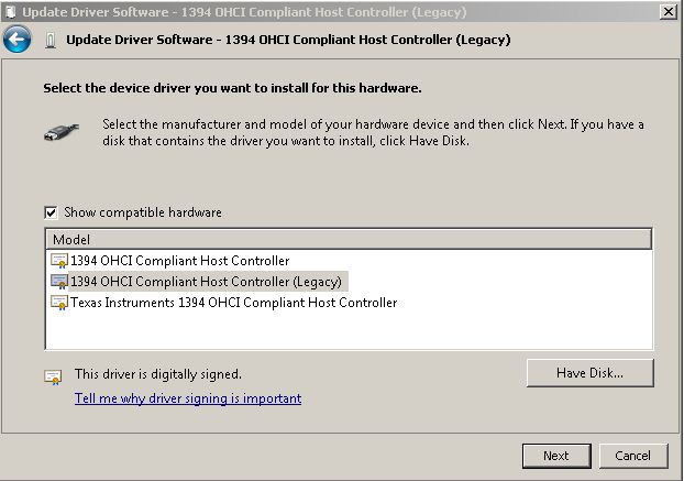

« Reply #5 on: May 26, 2009, 01:37:12 pm »
If you're intending to use a firewire interface with W7 RC, you'll need to use the legacy driver...
« Reply #6 on: May 26, 2009, 04:14:26 pm »
Thank you Mani !
It didn't even know the Firewire driver can be changed.
