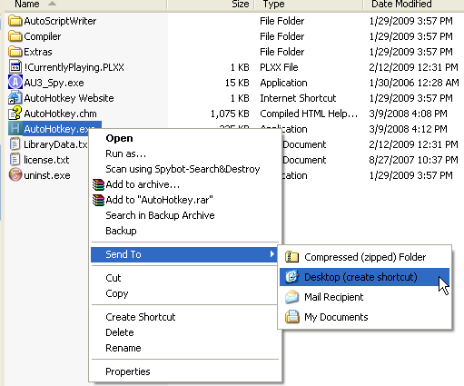

What I don't getright  is the 'send to... of the AH file. When I right click on the file or on desktop i never get this 'send to.."not even in Dutch :
what to do ?
Leo
« Reply #41 on: March 18, 2009, 02:23:30 pm »
Hi Leo,
Do you mean that you don't see something like the below ?
(this is XP, the right pane of Explorer)

In Dutch it is translated as : Copieren naar''.
Confusing translation if you think to understand the English language at least a bit.
But after doing this (creating a shortcut for the AH file) I don't get the right reply when I double click om AutoHotkey. It tells me that an older version is allready running and whether I want to replace that older version.
« Reply #43 on: March 19, 2009, 04:14:20 am »

« Reply #44 on: March 20, 2009, 12:17:36 pm »
Hello Peter,
I am experiencing the same behaviour.
I do get the green H shortcut icon created on the desktop. When I double click on it, the following message appears:
AutoHotkey.ahk
An older instance of this script is already running. Replace it with this
instance ?
Note: To avoid this message, see #SingleInstance in the help file.
                                                        Ja           Nee
Whatever I click, Ja or Nee, it does not matter: in either case, ALT-X does not bring up XXHE.
(so, until this has been solved, the goodies from 0.9x-5 cannot be used by me).   unhappy
Cheers, Eric.
