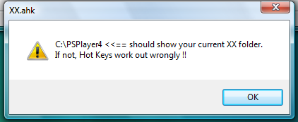

Ok, let's try to keep it simple ... Just do this :
1. Doubleclick the desktop Icon (green H). Answer Yes to the question. It can never harm.
2. There must be a screen "H" icon in the taskbar tray now. Rightclick that. See first picture below.
3. Click Reload the Script.
After #1 and/or after #3 the second picture below should pop up. In this case this tells me that my current XX version (the one I want to control with hotkeys) resides in c:\psplayer4\
In my case this is correct, so no problem. If it would be wrong though, it (if all is right) is solved by starting that XX version I want to control, and then again double click the desktop icon (green H). Again the second picture below should pop up, and now the inidicated folder should be the correct one.

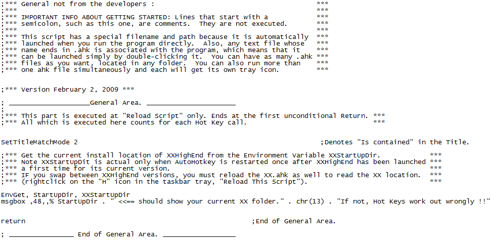

If one of these steps do not workout as intended, and assumed the green icon sits in the taskbar tray indeed, rightclick it, click Edit, and check whether the first part of the contents looks like the third picture below. If not, another application will use AutoHotkey on your PC. From there we can proceed, in a next round ...

followed your instructions up to Right Click Edit (previous steps did not produce required result). The following is shown in a new window:
; IMPORTANT INFO ABOUT GETTING STARTED: Lines that start with a
; semicolon, such as this one, are comments.  They are not executed.
; This script has a special filename and path because it is automatically
; launched when you run the program directly.  Also, any text file whose
; name ends in .ahk is associated with the program, which means that it
; can be launched simply by double-clicking it.  You can have as many .ahk
; files as you want, located in any folder.  You can also run more than
; one ahk file simultaneously and each will get its own tray icon.
; SAMPLE HOTKEYS: Below are two sample hotkeys.  The first is Win+Z and it
; launches a web site in the default browser.  The second is Control+Alt+N
; and it launches a new Notepad window (or activates an existing one).  To
; try out these hotkeys, run AutoHotkey again, which will load this file.
#z::Run www.autohotkey.com
^!n::
IfWinExist Untitled - Notepad
   WinActivate
else
   Run Notepad
return
; Note: From now on whenever you run AutoHotkey directly, this script
; will be loaded.  So feel free to customize it to suit your needs.
; Please read the QUICK-START TUTORIAL near the top of the help file.
; It explains how to perform common automation tasks such as sending
; keystrokes and mouse clicks.  It also explains more about hotkeys.
Next steps please........
