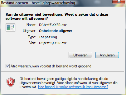

It's better as you see, but the slider does not go to the end but ends 1 cm before end. (than offcourse goes to the beginning). Music play's fine. As you see first start results in below error''s
Pic 1b3 apears 3 time's where it normaly apears only 1 time. The upper two before pic3...
EDIT: put in pic version 9b.....

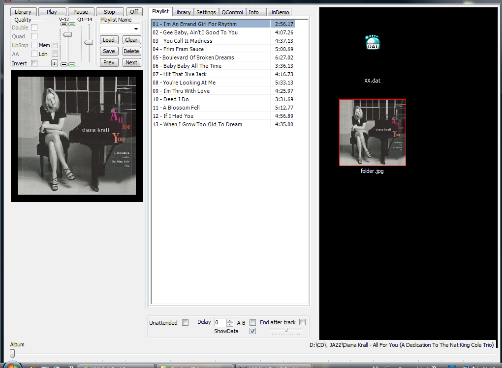

Btw Gerard, what is that XX.dat I see everywhere in your pictures ? Or is that from a rather old XX version maybe ?
« Reply #34 on: February 07, 2009, 10:08:46 am »
Ok super!!!
I don't know what it is.... Can i delete all of them?

have another question. As you can see from both pic's the above pic from dianna shows two stripes from the time balk next to each other. The pic from 9b has those verdeeld over the whole area... But if that's ok with you it's ok with me..
« Reply #36 on: February 07, 2009, 11:41:19 am »
Yes.
Those stripes have a different spread at the two pictures anyway. The first implies 3.5 minutes and the second 3.0 minutes. The second implies that you indeed did something with track 1 lastly, and the first implies track 6.
This is something I don't have under control 100%, and only when the track is actually playing Attendedly, it should fit that track playing. One stripe is 10 seconds.
To understand better about my "not under control", play a track Attendedly, then click on another track and do nothing more. Now the scale is wrong, but the cursor keeps on running. It may turn out in some anomaly when the cursor reaches the end ...
