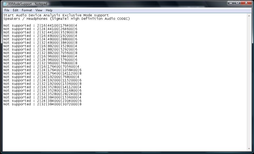

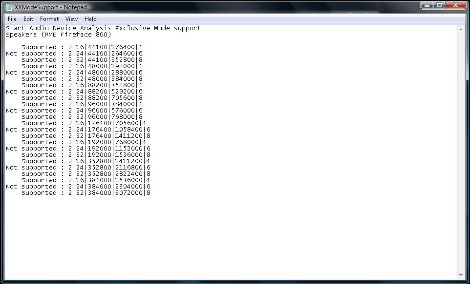

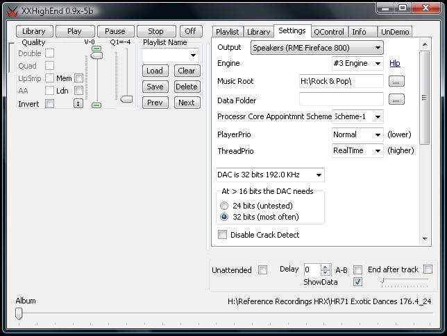

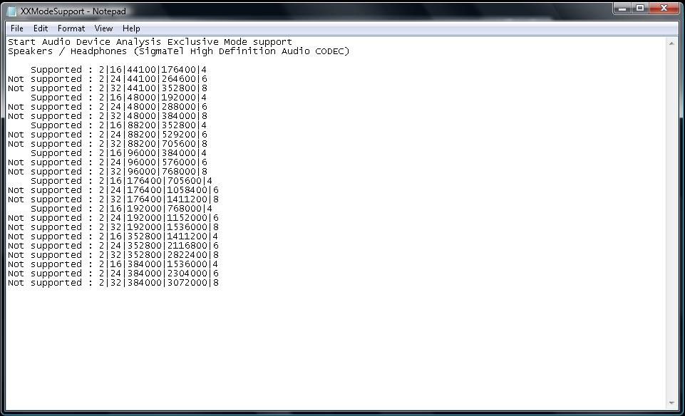

« Reply #22 on: March 26, 2009, 12:37:50 pm »
OK, so here are some images:
1) my devices
2) my XXHE settings
3) DAC Test with internal sound card DISABLED
4) DAC Test with internal sound card ENABLED (note: I have NOT changed the settings in XXHE - I still have the RME chosen)
With the internal sound card enabled, XXHE stops recognizing the RME (but it is still set as the default in Vista). If I play a track, it comes through my internal speakers.
Weird, no?

« Reply #23 on: March 26, 2009, 12:43:12 pm »
Sorry, last image is wrong - this was the result after enabling the SigmaTel, but before rebooting.
After enabling and rebooting, this is the result. Again, the RME is still selected in XXHE settings.
