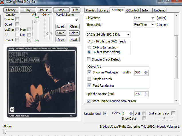

After installing 09x-6a I have the following problems:
no sound
playing in unattended mode only Vista background

09x-5b. I have tested it in attended and unattended mode.
Sorry, I don't understand ...
When playing music in unattended mode I don't see any trace (no wallpaper) of XXHE on the 8" LCD screen. The only thing I see is the background of Vista.
After installing 09x-5b again, using the same settings, all is working again! Music, Wallpaper,.

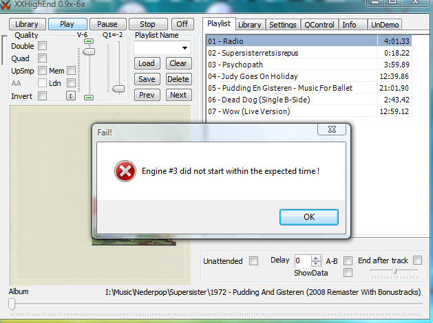

« Reply #3 on: April 02, 2009, 06:10:36 pm »

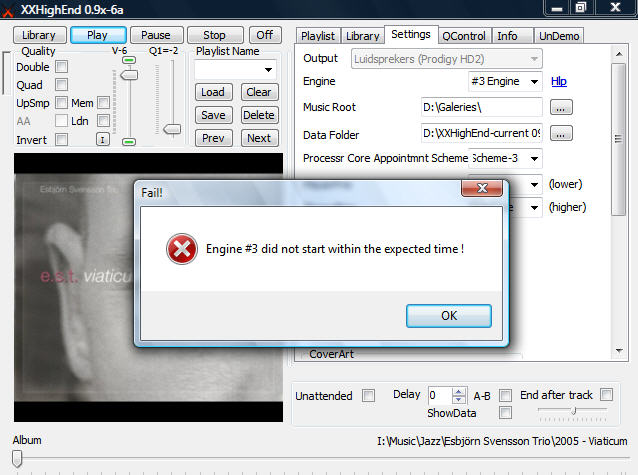

Same situation after a new installation.
no sound, progression indicator stays on the start position after a play command! (sorry i didn't tell that before)
See screenshot after play command in attended mode
See log file in attachment

« Reply #4 on: April 02, 2009, 07:29:45 pm »
Uh-ohhh
Johan, if this log file is the actual one from that session ... at 17:57:07 things go wrong in a way which is not possible.
In the program *or* a message that Engine3 started must appear, *or* a message "No Engine3 running message received" must appear. This latter is right above the message "Engine#3 did not start ..." as you showed, but that log entry is not there. THIS IS NOT POSSIBLE.
But in your case it is.
I don't know what to do with it. aggressive
The only thing I can say (without sense though) is : maybe that ö in Esbjörn creates problems ? It shouldn't, but who knows ...
I can't imagine that you have a 1000 other problems with this PC ...
Ok, you might post the test01.log file (in the current XX folder) after another attempt. It may show the wrong sound device selected ...
But even if so, it is impossible that the message is on the screen while the log entry is not there. If I ever had such things on my PC I'd stop with computers instantly. I mean it.

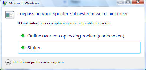

* test01.log (0.33 KB - downloaded 383 times.)
« Reply #6 on: April 03, 2009, 01:18:45 am »
I had also soundproblems in 09x-5 and i was not the only one.....
Yes, but those things can/could be explained, and if you follow everything closely you'll see that I am earlier to admit that something is wrong than most users. This (about the earlier logfile not being consistent with what your screen tells) is now the, well, howmaniest thing I just can't explain ?
Point me to one other user with situations I can't explain, and I'll admit that I don't understand a bit of computing. But you can't. It is only you, and always you. Your PC of course. Happy
Johan, I am waiting for the day that you get so annoyed that you will give up and are mad at me. I don't want that, and you (yes you) don't deserve that.
Do yourself a favor, PLEASE, and find some neighbour or friend, bring XX, use the settings you are used to and just see that it will work there (but in demo mode, so not everything will be the same).
In the end there is a slight other problem perhaps. You are one of the best to discover problems, or at least report them honestly. This is good, if not the best what I want. But when it comes down to diving into the merits of things (what actually causes what) you just may not know all, and btw, nobody asks you to. Not me anyway. However, if you, like the last time, *do* switch your processor to low energy mode, but do not know the consequences, or cannot recognize that this is special, better not turn on those kind of settings. You might have more. I don't know.
I have proven that you have rights problems, and I have asked you (maybe a year ago now) to DO something about that. You did not. Well, what if I again have used such a delete function your special system can't cope with ? maybe I have, I don't know. The program is full with "To solve JohanZ's problem". And believe it or not, only your name is in the program.
I have proven that your file system responds like a 8 Mhz XT from 30 years ago. Is that solved ? did you test ? I don't know. I also -now !- can't tell whether that log file entry would have come up after the more than 25 seconds you waited for it. It just as well can, because in other situations the same things happen. And mind you, writing a log file (being a text file) is 100% the same as writing a dat file which Engine3 needs. When it's not there in time ... there's your message. Why now and not before ? probably because I used something your system can't bear.

Me again...... unhappy

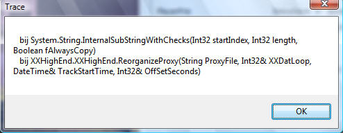

Switching to engine 2 XXHE is working with sound. Switching back to engine 3 gives the situation without sound. After a play command i get new error messages. I'll hope this give a clue? See attachments.
« Reply #11 on: April 03, 2009, 02:05:50 pm »
Yes, I understand this. Plainly my fault. This "ReorganizeProxy" thing has been made for Engine#3, and the other day I saw that part of what it's doing has sneeked into Engine#1 and #2. And because it *can* be part only, a next call to the Engine#3 situation fails. So all 'n all this will be because of you used Engine#2, and then hopped over to #3.

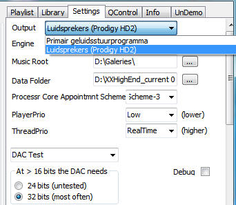

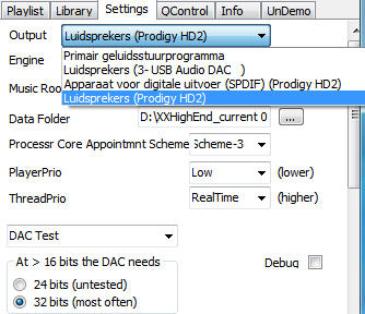

After connecting my USB DDDAC to the PC and selecting in settings "Output" to Luidspreker(USB) then there is sound. Switching back to my internal soundcard then i have no sound. Back to 09x-5b all working ok with this soundcard (all +/- 40 versions of XXHE i had this soundcard working ok).
« Reply #13 on: April 03, 2009, 04:35:13 pm »
Aha ! so now we may be getting somewhere.
a. What does the DAC Test say about that sound card ?
b. What happens when you switch off all the sound devices ("Uitschakelen"), except for that one ?
in this version 09x-6b the DAC test does not start! Only the USB DAC test works. See attachment
It makes no difference! No Sound, DAC test for the soundcard faills.
