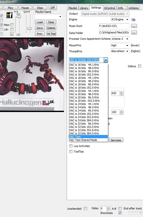

« Reply #3 on: June 04, 2009, 11:20:01 pm »
I think peter means this test

« Reply #5 on: June 05, 2009, 12:07:25 am »
  but I cannot make it start and show result
Select an audiotrack
Select DAC test
keep it in attended mode
select play button
XX wil do the test
i am not sure where you find the results. on the screen i think.....

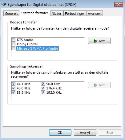

I came to think of one setting under sound devices:
properties:
3 tests are presented on dts/dolby or wma
and 3 test on
samplefreq  44 / 96 / 192
what to check and what NOT to check?
best
Leif
Those do nothing for Exclusive Mode (which is what we are using).

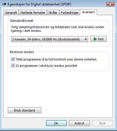

with dac set to 16/192 it plays the hi rez files
the info on the track says 2/24/96
had to uninstall the soundmax software from ad to make it work
THEN I was allowed to set rates etc in the sound devices:see attachments
why i don´t get 24/192 in test I don´t know!

« Reply #14 on: June 05, 2009, 11:06:36 pm »
Well Leif, this doesn't make much sense to me. So as I said, the file could be 16/96 (strange in the first place), but your DAC test shows in fact similar. Please note that XXHighend is able to play 24/96 files onto a 16/96 DAC, which seems just what you have been doing / setting now.
The first time that I see a "HD Audio device" properly working still has to come. But this one seems to beat all !
If you want you can still send me such a file, but as you said, it plays on Pedals system, so most probably the file is allright. However, I still wonder why XX tells you that the "384000" is not supported, while that is just the one which *is* supported (compare your earlier post with the DAC test and this number). So, I still think I do something wrong ...
