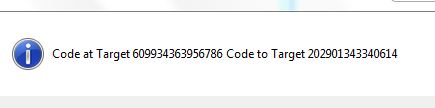

I did a clean install of Win and also downloaded XX again but get an error message when I try to activate it (see ErrrorReg.jpg) - Any ideas?

Hi Josef,
The new install requires a new Activation Key in the first place. I just sent you a PM about that.

Hi Peter - Got your PM with new activation code and it worked OK - tnx!
