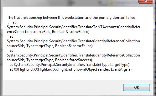

I did a clean install of Win and also downloaded XX again but get an error message when I try to activate it (see ErrrorReg.jpg) - Any ideas?

One more thing - if I do NOT start XX as Administrator XX complains that sound quality will be negatively affected which is nice - I do not remember getting that warning on Vista - However, if I just click through it will crash: see (NoAdminCrash.jpg).

On this matter, can it be so that you are on some "uncommon for home users" domain ? I mean, the message you posted directs to something domain related, although it could be a very common message anyone can receive (but I never saw it before).
