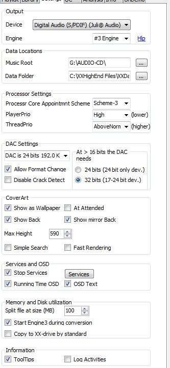

Hey Peter,
Thnx for this new version, at first glance looking really good.
XX remembers my settings and larger gallery looks nice.
But xx wont play. (even with "copy to xx drive by standard" disabled)
Roy

« Reply #4 on: August 13, 2009, 12:44:50 am »
see settings above,
And ofcourse using W7.
selected an album from gallery and tracks are shown in playlist
Then press play and nothing happens.

seperate FLAC files no cue,
Unicode file is in xx folder.
But simply doesnt start
Even when I converted my files to wav and "copy to xx drive by standard" disabled
Roy,
I can't get this. But looking at everything I'd say it will help if you untick "Start Engine3 during conversion".
Please let me know. Here is sure works (just mimiced your situation as good as possible).
One thing : The file you try to play here has a space before the dot like 01 - Pistolero .flac
Officially this can't be. I looked in the program combined with the log files, but don't see where it would matter, unless the OS itself chokes on it. You might try without such a space ?
Roy,
Goodmurning,
Its not that space, but it is wrong anyway.
I tried a dozen of albums, no luck yet.
Did what you asked, untick "Start Engine3 during conversion"
No luck either.
Grtz
« Reply #14 on: August 13, 2009, 11:03:18 am »
Roy, can it be so that when you expect things to play, XXEngine3.exe is running indeed with just very low memory ? (check TaskManager);
This is what I saw myself yesterday at the attempt I reverted (and just talked about). If so, I'll have a small clue to start with ...
