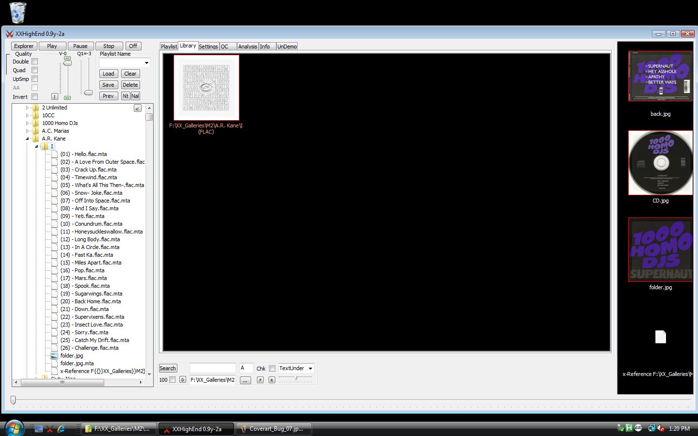

0.9y-2a, installed several days ago, but B.B. King issue isn't solved.
and its not only B.B. King, lot more albums with a dot in it.(not all)

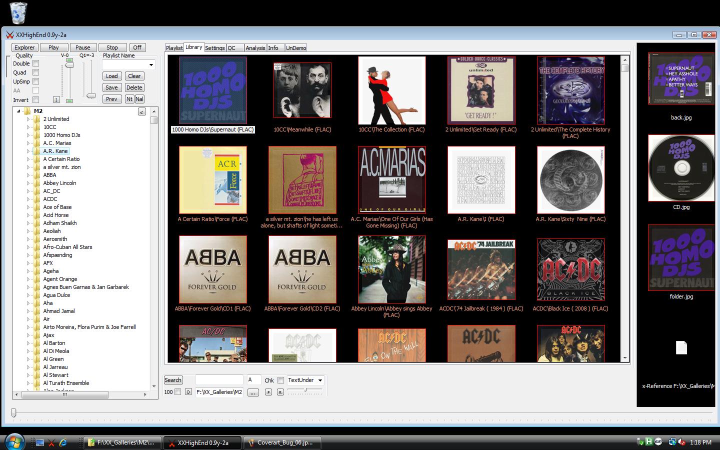

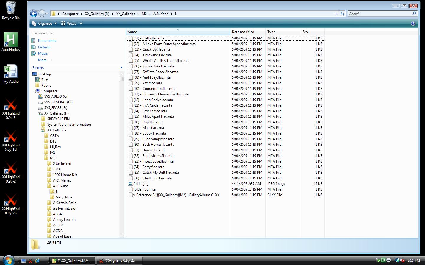

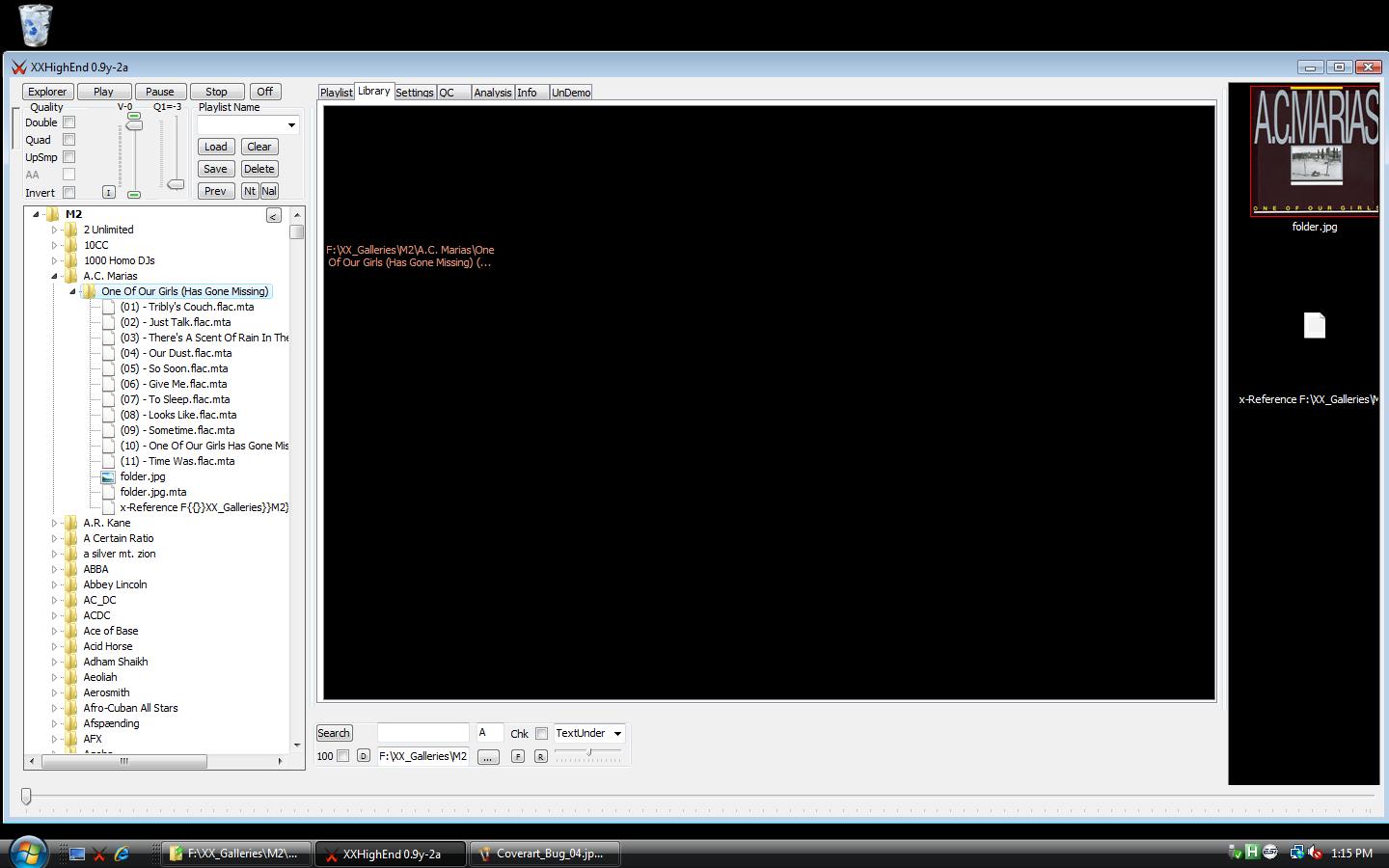

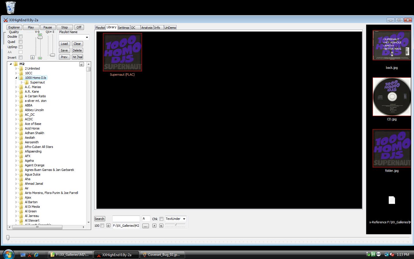

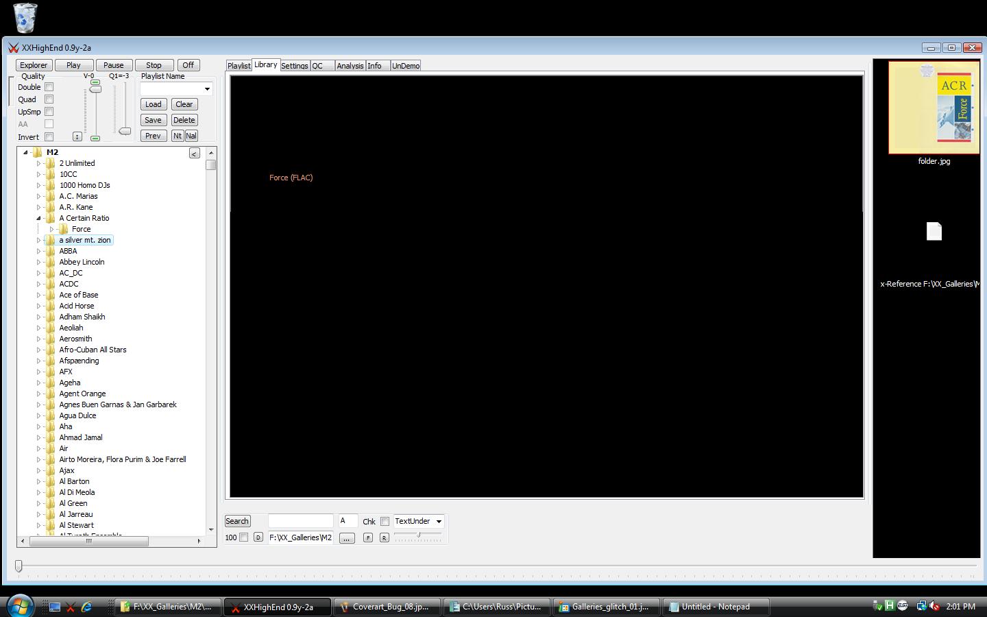

About the B.B. King issue ... can anyone provide me with a literal example, including the folder structure in use (a screen copy of Embedded Explorer where the album completely shows including the music files will suffice).

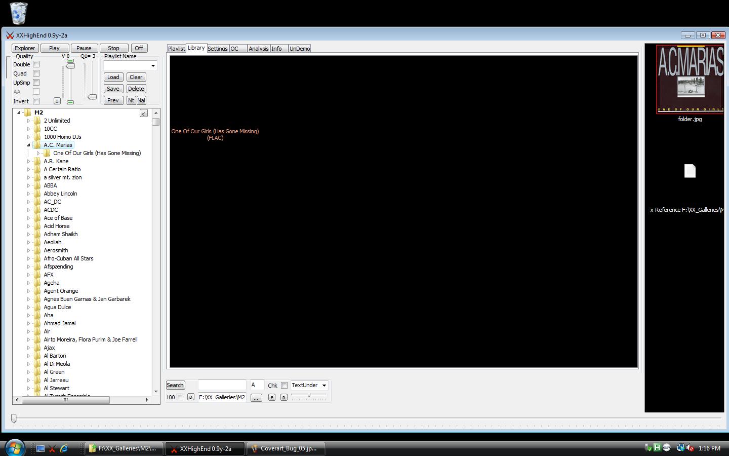

I have attached a few screen captures to try and demonstrate the coverart display bug I am seeing.
Coverart_Bug_01: shows the folder structure of my music. I don't currently have them split my genre's, but simply stored as artist\albumname format under a high level folder of M1 , M2 , etc, which corresponds to the disc volume they reside on.
Coverart_Bug_02: shows the initial layout when I click on the upper level M2 entry, with the first entry in the middle panel highlighted to show the other artwork in the righthand panel. Note that "A.C. Marias" , "A.R. Kane" and "a silver mt. zion" are shown.
Coverart_Bug_03: from the last picture I clicked on the entry on the left panel, and, as expected, the contents of the "1000 Homo DJ's" were displayed correctly.
Coverart_Bug_04: following the last picture I then clicked on "A.C. Marias" entry on left panel. Coverart for album appeared in middle panel.
Coverart_Bug_05: clicked on the album entry on left panel under A.C. Marias ( it expanded to show track listed as expected ), however the coverart was now missing in middle panel, although the path text was showing. The artwork showing in right panel was a leftover from previous 'click'.
Coverart_Bug_06: re-clicked back on the main A.C. Marias entry on the left panel and now there is no coverart showing, which differs from the "Coverart_bug_04" scenario above.
Coverart_Bug_07: starting from the view I got in "Coverart_Bug_02" , I then clicked on "A.R. Kane" and no change occured. I would have expected the contents of the A.R. Kane folder to be have shown now. Note: this is the same scenario if I was highlighting my "B.B. King" entry on my "M1" disc.
Coverart_Bug_08" If I click on the little 'expand' triangle to the left of the A.R. Kane album, and then highlight the "I" album, the coverart shows as expected.
Coverart_Bug_09: Just prior to this screenshot I had highted the "A Certain Ratio" entry on left panel. This pcture shows a null response when highlighting the "a silver mt. zion" entry. In a similar scenario to just above, if I expand the entry using the little triangle, and then highlight the album entry underneath, the covertart appears as expected.
Common theme in this bug is the presence of a dot (.) in the album name, and it maybe just co-incidental, but there are only 4 characters following last dot in the name _where you get NO initial response_. The positioning of these artist names within the folder structure may be having an influence either side of the actual entry.
Good luck in tracking it down Peter! It's likely another quirky m$oft gotcha where the pathing names are being mangled somehow.

« Reply #54 on: August 31, 2009, 08:58:18 am »
Russ, great. yes
I think I have seen all the situations pass by once in a while, but never really sat down to look into what happened exactly when. Well, here is my guide !
Your remark about the 4 positions to the right of the dot is key, because it at least prooves that it is me doing something wrong there; indeed I use the last 4 positions (max) to determined whether something is a file or a folder. There's no other means available except checking the existence which may cause a bunch of additional IOs depending on the functionality needing this info (just suppose I had to do this for each track each time Embedded Explorer shows).
But then this is dot-net and I guess I will be able to find some low level API function that is able to determine it (Explorer can do it, so I must be able to).
Allright, I will be fixing this all today, tomorrow ...

« Reply #56 on: August 31, 2009, 05:14:27 pm »
B.B. King and everyone he played with Happy, is solved for the next version (0.9y-3).
