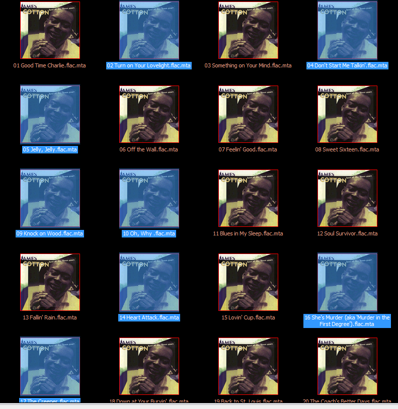

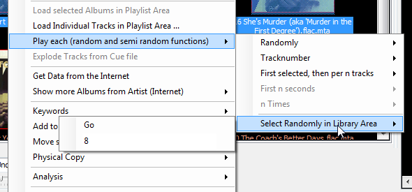

Eric, thank you (you are really overdoing it Happy Happy). What's new of course is your original selection from Embedded Explorer, but that is exactly what I did the last to ever get one album in there. secret
Interesting, isn't it?
NO !! heat
The hang I can imagine, because I take care that not any item will get in the result twice, and with the skip of the first (which is a bug) things will go wrong in that area. But no matter I "take care of that", for you this doesn't help a bit.
Do you perhaps recognize that your "selection means" is set differently ? like "one click" does the same as normally double click ... something like that ...
Below is 20 tracks with 8 output, done exactly the same as you.

Eric, try to help me find what is going on by examine other similar features. Please do this :
Go to the bottom option of that Randomize menu, enter the number you want to select and click Go. As I said before, it is this funciton which is being called, and I think at your side that works correctly too. But now click Load. If all is right those randomly selected tracks will be loaded in the Playlist Area (but in alphabetical sequence). But if all is REALLY right, and I mean consistent, that too in your case must come up with something else.
Please let me know.
