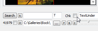

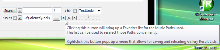

- Untick the Chk checbox when it's checked. Because, a. this is necessary in order to process a large number of Library Items (otherwise it will be far too slow) and b. you won't be using Checkboxes for selection during this process.
Think of the "genre" folders you may have you may want to use for randomizing. Whether they are the physical original music folders or Galleries does not matter. Pick one by means of the "..." button at the bottom or via the Embedded Explorer at the left.
To keep in mind : I talk "genres" here, because it usually is not the best thing to hear hiphop pass by along with Vivaldi.

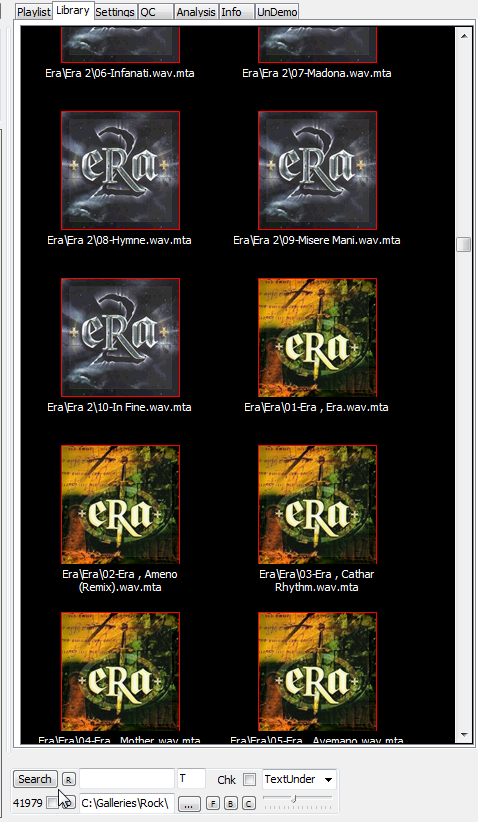

Now replace the default "A" for Albums with the "T" for tracks in that little box (see picture above). Next click Search.
Depending on how large the folder is this may take a while, because all the tracks in there will be collected, and presented to you in the Library Area. Might you have a 10,000 albums, no problem, but expect over 100,000 tracks to be there. That may take a minute or two.

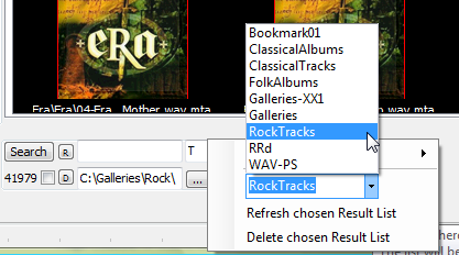

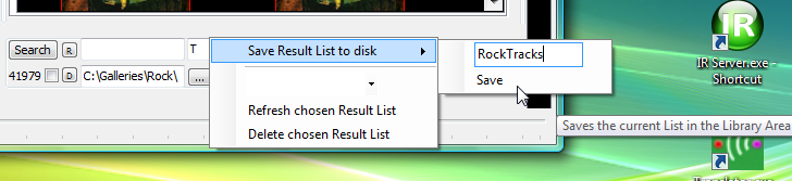

Now, just because this may take two minutes, we are going to save the result as a Saved Result List. You could call the List Rock Tracks if this is about rock as a genre, so you will know later. Rightclick on the small F button to get there.
Step two : Get the tracks to randomize
Ha, but we just done that ? yes, true, but this assumes it now is "tomorrow", and helps you understand why Step one was important.

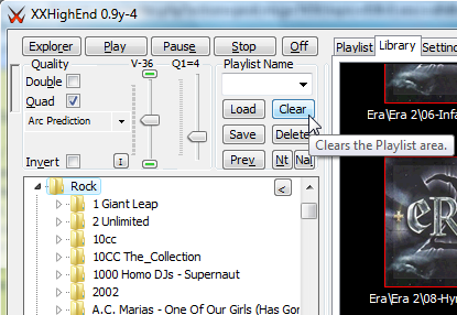

Before you forget, you may want to click Clear in order to clear the Playlist Area.

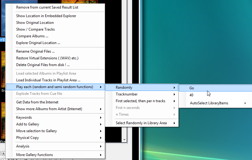

Now, rightclick on any of the Items visible in the Library Area. Which one you click is not important.

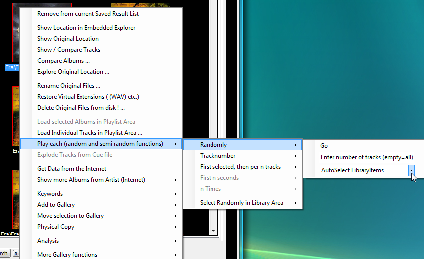

Go to Play each ... and choose Randomly. From there, go to the combobox at the bottom, and select AutoSelect. This latter means that the system is going to select the Items to randomize (don't read this again, or you won't understand Happy).
Now go to the "Enter number to randomize" box, and there enter the number you expect to play in this session. Remember, don't make it very much longer than you expect to play, because in a few seconds you will be starting playback, and as always the Playlist has to be prepared (converted etc.), and the longer it is, the more time it takes. Of course I expect Unattended playback, which is advised for the best sound quality; if you are going to play Attended, the output amount doesn't matter much, but keep in mind that for each track to appear in the Playlist Area, the Coverart must be collected. On this matter, 40 tracks will take about two times the time needed for 20 tracks.
Let's say you chose 40 tracks to output to the Playlist Area. Now you are ready to click Go.

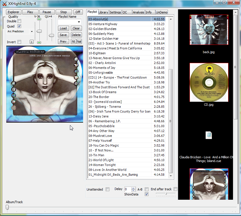

No Peter, the albums are not CUE files. There are 11896 tracks in the Library Area result list that I am working with.
This is what appears in the Playlist. 20 tracks (as requested by me) which I numbered topdown for this discussion.
When tracks originate from the same album,  I put them on the same line here below.

So the tracks come from 12 different albums. Moreover, tracks number 11 and 13 are not only from the same album, but they are actually the same.

So now the tracks come from 11 different albums. Moreover tracks 9, 11 and 19 are the same track.
Wouldn't you agree that this is very curious and suspicious at the same time?
