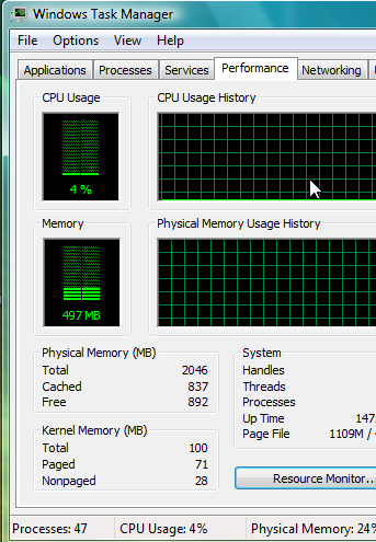

But your memory useage worries me. You know, even outside the "virtual memory" on disk, there's a similar thing "in-memory", and although it depends on the processor, to me it seems you have exceeded it ! (a rather normal limit is 1.3GB). Also, thus far it is the only explanation I have. For this, don't look at the 0.9x versions because they work differently for memory allocation. Now :
If this is the culprit at all (but let's assume this at not knowing anything better), your idle useage of over 900MB is some 500MB too much !
And no, don't ask me why. Now, keep in mind all is relative :
Let's say 500MB idle useage is normal. Also, the normal limit is 1.3GB for 2GB of memory (this is that "virtual" thing). This gives 800MB of useable memory for playback. Now your case :
This would be 900 idle useage with the same limit of 1.3GB, or 400MB of useable memory for playback. This is twice as less ... (and really too few !).
You may use TaskManager to look for those momory consuming programs ?
Great data you provided there Harry ! now on to the solution !
