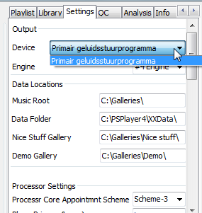

Here my logfile
________________________________________________________
Start KS here
Name wanted  : Primary Sound Device ||   Number of KS devices found : 1
Filter found : \\?\audiotrak#pdhd2_01#5&2f0b5d3f&0&0001#{6994ad04-93ef-11d0-a3cc-00a0c9223196}\esi_wave
Name attempt : Prodigy HD2
No ambiguous devices found.
Selected device not suitable for Kernel Streaming
Any suggestions for me?

« Reply #21 on: January 12, 2010, 11:25:10 pm »
Also ESI !!! Johan
« Reply #22 on: January 12, 2010, 11:30:10 pm »
Hi Johan,
Change that name into "Prodigy HD2" should do it I guess ?
Also ESI yes, but this one will work ! evil
Edit : uhh ... huh ? you did that. But now you didn't select the device ? (but "Primary Sound Device" instead ?)
« Reply #23 on: January 12, 2010, 11:34:43 pm »
Did mean replacing "Speaker" for "Audiotrak HD2"?
« Reply #24 on: January 12, 2010, 11:39:44 pm »
yes
But it looks like that won't help (if I read my own outlay earlier in this topic).
But you didn't select the proper device ! (well, as it seems, see the quote in my before post)
... But I must honestly say, even if you did that, it shouldn't list "Primary" etc. but the actual Device Name. Unless ... unless there are no devices at all (only "Primary") but *then* you have another kind of problem (like no Sound Devices).
« Reply #25 on: January 12, 2010, 11:49:33 pm »
So this would be a never working situation (and I just noticed that this will NOT produce a "check sound device" message !) :
