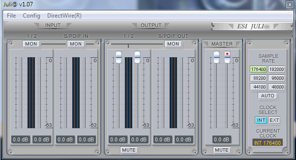

Ok, after I knew it worked (by now for AUDIODIDAKT too, as I understand from another topic), I went back to the original (latest) drivers.
Followed the kind of same procedure as I described earlier.
Now I discovered that the "Auto" (sample rate) setting doesn't work anymore. This, while before I never could dictate a specific sample rate.
Does anyone know how to deal with this ? Before I always tried (reinstalling etc.) to get the fixed rate working, and I never succeeded. No problem in the end. Today I obviously want it to be the other way around (auto-select), which *is* a problem if not working.
These drivers (1.07) obviously aren't quite up to the (Vista/W7) job, also looking at the only 2 devices showing, while 4 are actually in there (the Ch34 and Ch1234 additionally).
(see below, where the "Auto" box is White and can't be changed to (active) Red; before (1.07 as well as 1.21) it always has been Red, and couldn't be changed)
« Reply #12 on: January 21, 2010, 07:26:10 am »
Ugh,
I got it working by using the right drivers, but there are more drivers to test. (Juli@-x2v-v0_974 is the one working now)
Oops..........
I have same experience, before I couldn't select sample-rate, with older (for kernel) drivers I can.
But didn't go back to newest drivers yet, will try today.
