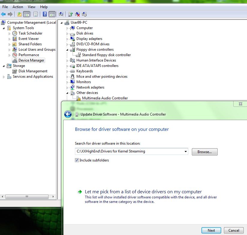

This part is a bit twirky, but probably just Windows 7 (because I saw similar before) :
Install the Juli@ again from the Unknown Multi Media Controller (and not from the Sound Video and Games section -> won't work).
Notice that this Multi Media Controller only shows up when the Juli@ is without driver, and probably when you applied a Search for new devices (from rightclick on the top node (your PC Name).
Also notice that you will be needing an "Upgrade Driver" option, and at first it is not there. I am still not sure what it takes to get it there, but it will be there at "some stage". To keep in mind : I passed a stage where W7 tried to install the device on its own, which will fail because you removed the drivers from the system. This pass may be needed in order to get that Update Driver option there. "Search for new devices" should get you into that pass, but I don't know anymore.
5.
Manually denote the driver's place (where you unzipped below zip).
6.

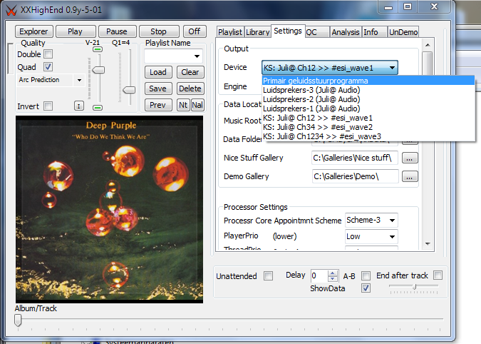

Start XXHighEnd and find yourself with 3 nice KS devices. I think Ch34 will be the one you're normally looking for (since Ch12 works for me which is "Loudspeakers").
8.
Of course you can't wait trying, but maybe spend some time in renaming the 3 "Loudspeakers (Juli@ Audio)" devices, where one of them will be the one needed for Engine#3. Don't expect the first one to be the one you used to use. I renamed them from top to bottom, the first into Loudspeakers-1 (which moves to the bottom because of that) the second one into Loudspeakers-2 (also moves to the bottom) and the third one into Loudspeakers-3;
Notice this is necessary in oder to let play the good ol' Engine#3; when all are called the same you can only select "one" of them (whichever it is).
In my case Loudspeakers-2 are the same as the before one "Loudspeakers" showing. It seems that Loudspeakers-1 is the SPDIF one (but notice my sequence of renaming) and the remaining one (double bonus) will be the 4 channel SPDIF version, not available before.

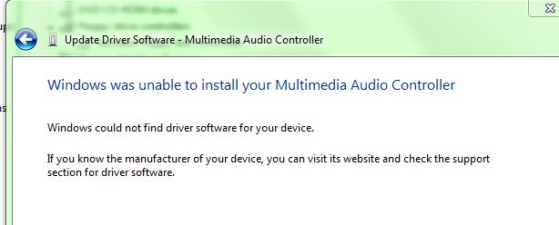

« Reply #8 on: January 17, 2010, 09:57:52 pm »
I have uninstalled Juli@ drivers........
extracted new drivers to folder.
when I want to update from that folder,
I get this screen....

« Reply #10 on: January 18, 2010, 09:16:59 am »
I Already tried an XP64 driver yesterday but no luck.
