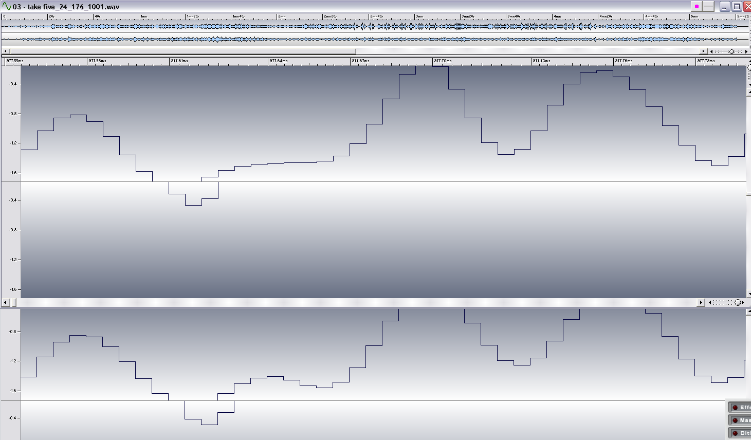

« Reply #46 on: August 19, 2010, 06:12:58 pm »
Ok. With my own statement in mind "an AI upsampled file can't be compared", I thought "but wait, this never was an AI upsampled file ... this was the result of an OS DAC with something "like that" in it. So, let's see ...
Was I wrong on thinking AI couldn't be compared ...
What you see here is just that; At the top is the original 176.4, and below it you see the AI upsampled file, with Josef's 16/44.1 as the base.
Remember, the 16/44.1 was the decimated version from the same 176.4 you see here at the top ...
Yes, in the top channel (at 1/3, but notice the scrollbar at the bottom !) you see an anomaly, the AI version showing a bump, the original just showing a slightly upwards going slope.
Notice that I can not know whether this is cause by my AI upsampling, or whether it is caused by the decimation process from Josef. And no, I am not going to find this position in his file. Happy
But these anomalies are very very rare; I have been browsing through this step by step for 45 minutes, and found only two of them (see later for the other one). Can this change sound ? maybe, if only enough are there. My 45 minutes of browsing was worth 6 seconds of music ... (I started at 1 minute, going backwards).
Also see next posts for some clues ... yes

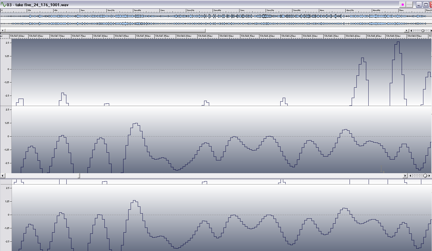

« Reply #47 on: August 19, 2010, 06:20:19 pm »
A little zoomed out. What we see here, I only saw after a long time as a pattern ... what do you see ?
Look at each of the peaks and compare the both takes ...
Do you see it ?
Somehow there is a consistent "opposite" balance in how the peaks are formed. Just find a peak where one sample bumps out. It doesn't matter where you find it. Now look at its counterpart. See ? the one with one sample jumping out has 3 samples to *let* that sample jump out, where it counterpart has an even number of samples for the width concerned, and it is impossible for one sample to jump out.
If you try to reason where the "base" of this emerges, at least it is hard to see, but it must be at the base of the wave somewhere, where the one is wider as the other.
This is a most consistent thing throughout the both files !
Will this change sound ? ha, you bet it will.

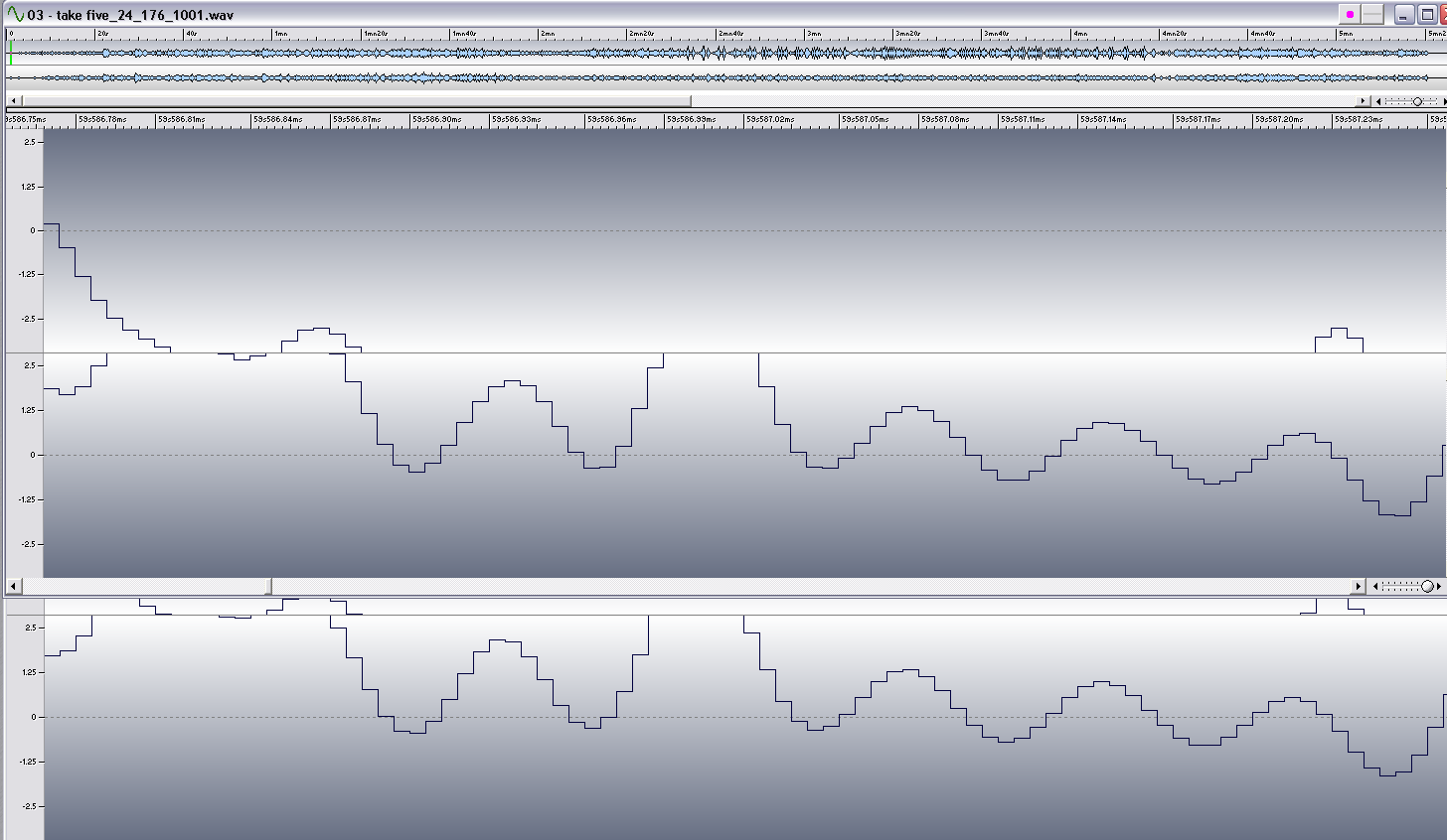

« Reply #48 on: August 19, 2010, 06:27:16 pm »
Two other examples, and nothing new. The first one contains an anomaly again (at 2/3, but notice the scrollbar at the bottom !), and further you again see what I talked about in the before post.
Notice that it is not in 100% of cases like the rightmost two pointing down ones (the second one is just visible in the upper right corner of the bottom half (screenshot) of the first picture).
But generally this upsampling means is very very much alike the original. What ? it is 1000 times better than I ever expected.
I should even listen to it ! haha
EDIT, PS: I'm not sure whether it can be the cause, but it looks like the upsampled version is one sample shifted opposed to the original (like skipping the first sample). In the end I don't think this is true, but if you look at the first post of this last sequence, you can see that the bottom part is not time alined with the top part. Still it is ... So, if the upsampler shifts one sample, then you'd have something like this. I think.
EDIT2, PPS: I just saw that the 2nd picture in this post, at the very right (use the scrollbar for that) also contains an anomaly. I didn't see it at first, so there may be more than I have noticed.

« Reply #50 on: August 19, 2010, 07:51:55 pm »
If you could repeat QAI with 'my' 16/44.1, you could see if these bumps are there also. If so, it's likely to be AI doing this, no?
EDIT: No, of course you can't - they're not aligned, and you're not going to do that, right?
