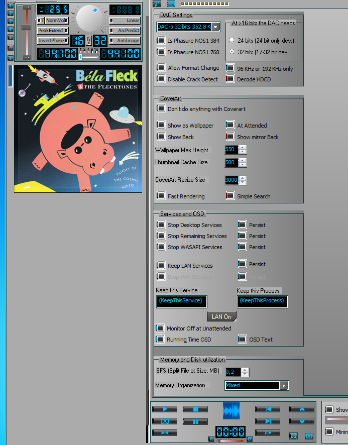

« Reply #40 on: September 25, 2011, 05:07:22 pm »
Okay, test. See picture for test configuration (minimising possible resource hungry functions as far as I can tell).
What happened after I click on [PLAY]:
  • XXHighEnd dissapears from the desktop but desktop stays (no Cover Art shown at first)
  • One time Alt-Up, XXHighEnd appears in Taskmanager and disappears after a few seconds, volume did not change.
  • Again Alt-Up and XXHighEnd shows again but does not want to go away on its own and after some time a popup message comes up telling me about a Wrong Command. Apparently the first command was still on going hence the error after the next command
  • Removed all extra XXHighEnd from memory through Taskmanager and did Alt-N for a next track.
  • Next track starts playing and Cover Art shows but it does not look the same as before (volume part shows ".0")
I wanted to make a screendump of the shown Cover Art but I am not able to have XX to show me any covert art at all again (as background).
Even after rebooting et all, no more coverart to be seen at unattended?
Anything else you want me to check?

« Reply #41 on: September 25, 2011, 05:38:05 pm »
Okay, covert art shows after half hour playing without touching anything...?
Alt-N plays next track and only one XXHighEnd shows in taskmanager, so far so good.
For Volume nothing changed (Alt-U, extra XXHighEnd showing in taskmanager, gone after a few seconds, no volume change) but also the cover art does not show any changes (-34.5 still -34.5 after one Alt-Up).
After 10 minutes trying Alt-Up once more but after a short while the Wrong Command Error shows again.
No visible changes whatsoever.
« Reply #42 on: September 25, 2011, 05:39:19 pm »
Hey thanks Bert.
In between lines : I don't think SFS=0.2 can play well, or otherwise maybe other anomalies may occur (as well). Not sure, but it could be better to test with a normal SFS. Okay, you of course did that long ago.
It would be interesting to have the log files of this exact situation (from your post with the picture !). Can you still find them ? (please don't make mistakes). If you are not sure, please do it again, and in the mean time use a larger SFS (12 would be very ok).
No hurries Bert, but I *do* want to solve this at last ...
(well, you know)
PS: I prefer to have the log files of the exact situation. I mean, it looks like you perfectly described what happened, and it is important to not have another situation in the log files than the text implies. To let you write the "perfect" description again is also something I don't like you to do (have a beer instead).
