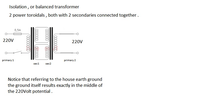

And my question is : do we really need the Earth connection ( safety reasons aside ) when using a balanced transformer?
I ask that because the canncellation by itself its so good in balanced mode , that I don see any of the problems coming throug the skin or speakers , when I connect all the gear throug the transformer and *without* the Earth connected . Problems that are easy to test in unbalanced mode and without an Earth ground connection .
stefano .

« Reply #70 on: July 25, 2012, 08:12:06 pm »
this is my experiment today (diy).
I believe toroidals have better bandwith anyway, but I may be wrong on this .
I did connect PC , Monitor and Amp to it .
