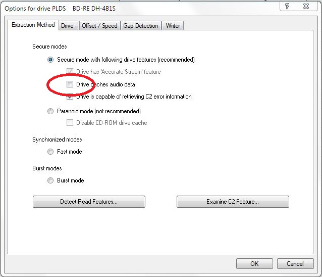

« Reply #23 on: December 15, 2011, 11:27:02 am »
OK, to use the 'force unit access' command in EAC, this is what you need to do:
EAC shortcut
1. set up a shortcut for EAC (on your desktop, or wherever)
2. go into shortcut properties
3. add '-usefua' to target command line (see jpeg below)
4. go into Advanced, and select run as administrator (just to be on safe side)
EAC Drive Options
1. go into EAC drive options
2. Under 'Extraction Method', untick 'Drive caches audio data' (see jpeg below)
WARNING This method is only guaranteed to work with 'real' Plextor drives. Ordinarily, you should never deactivate the cache in EAC because 99.9% of drives have a cache that cannot be deactivated. In which case, your rip will go ultra fast, but you will be ripping in the equivalent of 'burst mode'... NOT GOOD!

« Reply #24 on: December 15, 2011, 03:39:25 pm »
I just wondered ... is this not clear to only me ?
So, 99% of drives have a cache which can not be deactivated ?? Supposed this is true, than those drives are 100% useless.
I don't know whether it is true though, but it very well can be.
Never deactivate the cache in EAC ? Hmm ... I would say that you meant to say never *activate* it.
All summed up, no cache should be active anywhere.
« Reply #25 on: December 15, 2011, 03:49:35 pm »
Ah but that's exactly why it's important to get a 'real' Plextor drive and deactivate its cache using 'force unit access'.
If you untick 'Drive caches audio data', but don't actually deactivate the cache, you're in trouble...
The best thing to do is to use the 'Detect drive features' button. With 99.9% of drives, it will tick the 'Drive caches audio data' box automatically. However, with a 'real' Plextor drive, if you use FUA, it will automatically untick the 'Drive caches audio data'.
Anyway, as I said, there is an easy test. Get a badly scratched CD. If the drive does not slow down (almost to a stop) on ripping, then you're in the equivalent of burst mode.
EDIT: And there's always Accuraterip. If Accuaterip is verifying all your rips as accurate, then they are! In which case, totally ignore everything I'm saying...
« Reply #26 on: December 15, 2011, 05:13:47 pm »
I can't say that you cleared up much from your previous post. Maybe read again both my post and yours I responded to. They look opposite to me.
« Reply #27 on: December 15, 2011, 05:48:04 pm »
Peter, I understood your post perfectly.
We both agree that we really do not want to use the cache during ripping.
However, you believe that all that is required is to deactivate the 'Drive caches audio data' box in EAC. I believe that this will give you 'disastrous' results... unless you really bypass the physical cache in the actual drive also.
And there's only one way I know of to really bypass the physical cache in the drive - get a 'real' Plextor drive and use FUA.
But look, I researched all this almost 10 years ago now, and maybe a lot has changed since then?
« Reply #28 on: December 15, 2011, 06:11:43 pm »
Haha, how do we have this misunderstanding ... could be my unknowledge (btw, I have had a Plextor (something like 600 GPB) right from when it existed - until it died (producing read errors (and thus write) which were NOT detected by EAC ... just saying)).
What I don't see is how the cache in EAC will *ever* improve on anything, except for read speed.
So, cache in EAC should be deactivated always.
And next, any drive with cache is unsuitable in the first place.
So ?
(I don't want to be your pain, and let's agree this is about the good advice for others)
« Reply #29 on: December 15, 2011, 07:20:15 pm »
Here's what the developer of dBPoweramp has to say about the cache:
"Caching is employed by the majority of drives to improve performance, but caching stops secure extraction: when a secure ripper tries to re-rip the same section a 2nd time, instead of getting audio from the disc, audio comes from the cache (which is the same as the first rip). A secure ripper must be able to detect and invalidate the cache (by reading more than the cache value before the section of audio desired)."
Read that last sentence very carefully (the emphasis is mine)!
If you deactivate the 'Drive caches audio data', then the ripper will NOT try to read more than the cache value. This is perfect... only if the drive has no cache (99.9% do have a cache!) OR if you've bypassed the drive's cache using something like FUA.
Now look, I don't want anyone to get paranoid about the 1000s of rips they've made. If you're worried, check a rip with Accuraterip - it's as simple as that!
