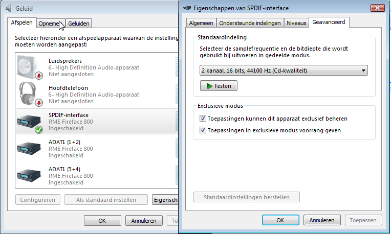

Did you tick the two checkboxes as shown ?
If yes, did you get the latest (signed) drivers for Vista ?
Does your device show (left screen below) as your sound device properly (opposed to "loudspeakers") ?
Lastly, did you make your device the Primary Device (as per green tick in the left screen below) ?

« Reply #3 on: October 06, 2007, 01:46:47 pm »
Ah, so you're using Analogue Out ...
I don't think I have ever seen that working ...
I must honestly say I never dove into it, but it looks like that using Analgue Out of a soundcard just will not allow Exclusive Mode. unhappy
If you'd have a DAC to put behind it ... (spdif)
The next problem you (we all) have, is that the combobox (where yours shows 24/192000) does not allow for 16/44100 (or does it ?). I mean, what would be output from the program is 16/44100 (or 16/88200 at Double/Uprate), and since Vista *ALWAYS* resamples to the selection in that combobox, the program tells you that the samplerate is not supported ... (because it isn't). Note : "always" is except for Exclusive Mode.
All would leave you with Engine#1 or #2, and the only thing you'd get from that is ... resampling. Not worth a thing ... bad sound.

Apart from that this most probably will prevent you from using Exclusive Mode (but try the beta if you ever can get it to download !), you MUST select 44100/16 in the combobox. Without that, you'll get the second message (sample rate doesn't match).
Note that this combobox is for Shared Mode only. In Exclusive Mode it's not effective.

BUT ALSO SET THE OUTPUT TO 44k1 (in this post) you actually showed a WRONG setting, while I in the post after that pointed out that you should choose 44K1 in there. Did you ? can you ?
If you can't set things like I showed here, and if not indeed where you most probably can choose 48K only, your card will be resampling to 48K, and ... and now I don't know.

Please answer the question whether you can choose 44K1 in that screen I showed.
