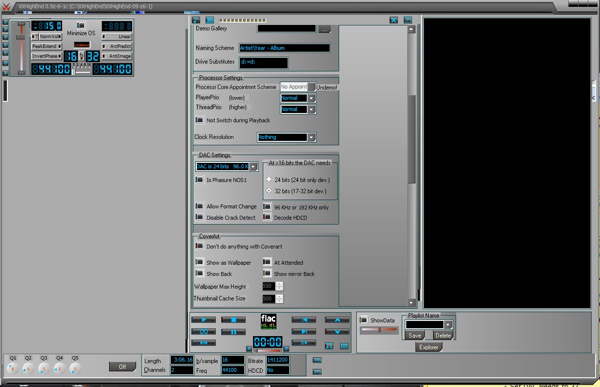

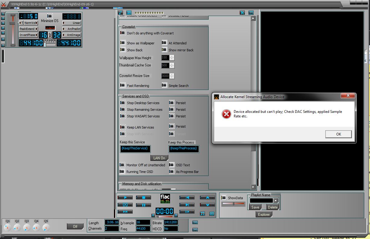

I'll give it a try in English. So far nothing is working when I changed settings.  That's why I give 3 shots of picture of my settings. The showed error message is always the same and it appears in about 4-5 seconds.
Changing engine setting is difficult and unlogical, because the DAC already comes with the KS setting.
ANd you can see the DAC brings withit that he is 24/96 . So are the other tips ?
Gr. Dirk

Oh, those screenshots are great.
