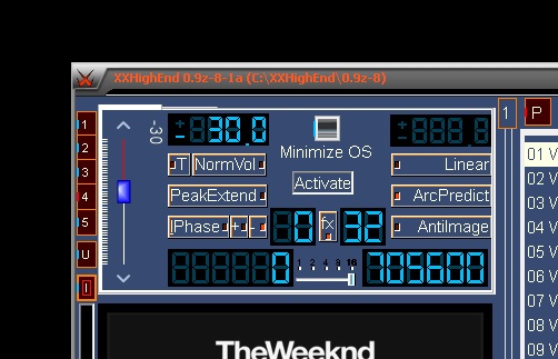

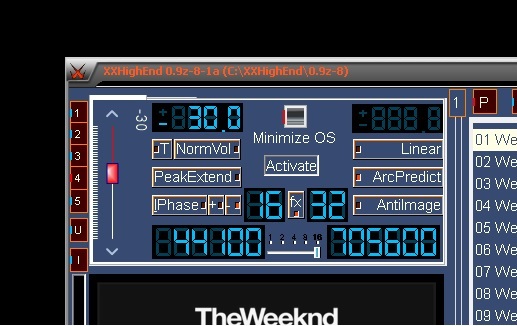

I don't have any wallpaper in Attended any more. It worked before activating and once after activating (but was still yellow), but hasn't since then. The background just goes black and all the desktop icons disappear. XX remains and seems to work just fine.
Hence my earlier question as to whether there was another sure fire way of knowing that activation was OK. I've attached a few screen shots - are these enough to be sure?

« Reply #10 on: February 02, 2013, 11:16:16 am »
Mani, yes that is enough. But not when you state that your Wallpaper is yellow. Then something looks fishy.
Btw, if now no Wallpaper appears anymore (in Attended) something is wrong. Look in your XX folder for (IIRC) .bmp files. You will see whether they are Wallpaper related (standard or from an album). Delete those.
It now may happen that even your normal Wallpaper doesn't show anymore after a playback (Attended) attempt. If that is the case, set it again (Personalization or something).
Does it now work again ?
I had to apply very trickery stuff to get the Wallpaper going in the first place and it may have failed.
If you can't get it going anymore and you want it back, I can dig up a Registry key to reset. So let me know.

« Reply #14 on: February 02, 2013, 11:30:34 am »
check whether it is actual.
Yes, but how can I do this when I get no (edit: album-related) wallpaper in Attended?
I checked the bmp files, and there was only one there which was Wallpaper.bmp - my Windows wallpaper. No album-related bmp files. So, when I go into Attended, I get my Windows wallpaper showing. Unfortunately, I always use a solid black colour for my wallpaper, which is where the confusion stemmed from I think. So Attended is showing Wallpaper.bmp for every album.
I think the yellow wallpaper I saw immediately after activation was indeed an old wallpaper.
