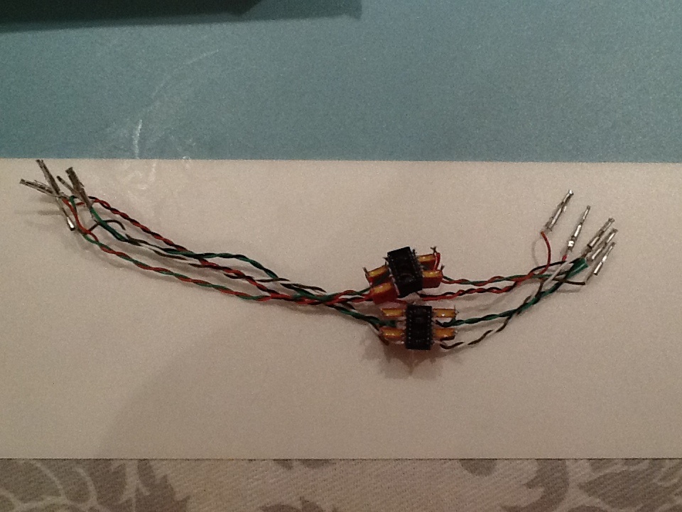

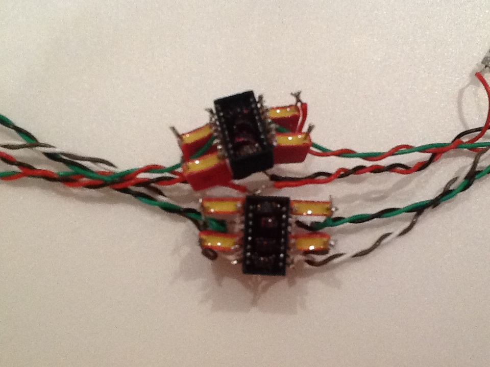

On another subject I spent half a day building a transformer isolated I2S lead last weekend to try in my NOS. I was not really expecting it to be successful given the link speeds but though it would be fun to try. At 16x up-sampling I managed to get reasonably good electrical wave forms across the lead but I think the rise times of the transformers put the data streams out of sync. I did get some music playing (which was very surprising  Happy ) but under a massive layer of static.
I might spend a bit more time with it to see if I can pin down specifically what is happening. Also it might me fun to try at different upsampling rates just to see what happens.
Here's a couple pics of the "creation"  Happy

Haha, I can show you similar pics Nick; can't work. All these means (and the digital ones for sure) only add jitter if you can get a good signal from analogue to begin with. But really, an anlogue transformer is too slow. This is not related to the sampling speed. You will always get "rounded" "waves" while it should be square.
It can be done though, but the how is a big secret.
« Reply #64 on: October 30, 2013, 07:17:19 pm »
Very nice  Happy could that be on a piggy back board or built into a lead  haha  Wink
