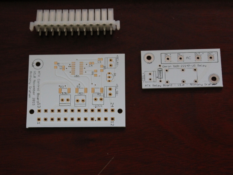

« Reply #197 on: December 02, 2015, 08:48:03 am »
ATX Control Boards and Relay Boards arrived this week.  All the parts are here to populate them, but I am waiting on some transformers and heatsinks for the power supplies that these boards will control.  Hopefully next week everything will be here but in the meantime I will populate these boards and do what testing I can this weekend.
The ATX Control Board is all SMD (a first for me) populated both sides.  You can see the P24 connector that will got directly to the P24 on the motherboard.  The little single sided ATX Relay Board will go down in the first stage of the power supply (a separate box) and will switch the AC for all rails that are not 5V Standby.
The first power supply that I will build up will consist of 8 rails using LT1083/1084/1085 and TPS7A4700 linear regulators, often cascaded to get a good noise result by letting the first stage do the heavy lifting of the voltage regulation and then a second stage inside the computer with minimal voltage drop (and therefore heat dissipation) and hopefully some excellent low noise performance.
Once I get this all working, then I will build the really high performance supply using some newer but more difficult to use linear regulators to see if I can get a better result because of even lower noise.

Hi Anthony,
You worry me a little. I wonderd what you are going to use these regulators for, they are all 1-1.5Ampere max. Everything except the processor? The motherboard can draw some power on the 3,3V for peripherals and mind you that 1,5 A is only 5Watt. For harddisks and PCI usb cards the regulators you mentioned will be ok. Be shure to add sufficient heatsinking even when cascading.
I would use beefier LDO regulators or bootstrapped ones for the motherboard and processor (100w = 8Amps @12V). At these amperes you should have considerable heatsinking even with LDO.
My i5 PC consumes over a 100W on boot. When playing music the LPSU heatsinks get really hot in summer and it supplies less that 70Watt from the powerstrip (for 50 Watts that the pc uses). That heat comes from the 20Watt difference in input and output.
Regards, Coen
Posts: 781
« Reply #200 on: December 02, 2015, 06:10:50 pm »
Hi Coen,
The LT1083/4/5 are nominal 7.5A/5A/2A respectively, so there is plenty of current available.  Perhaps you have them confused with other LDO's?
The heat sinking is quite something, and if the first stage is run at their maximum current load the LDO's will dissipate about 90watts between them, so I have two great big heat sinks on their way to me that should handle that load with a 20C increase above ambient, which in my experience will still feel quite warm.  There will even be two heatsinked diode bridges for high current rails.  At this stage I have opted for off-the-shelf power transformers and I really don't know what their temperature rise will be, but hopefully not too high.
Anyway, hopefully I can get the ATX Control Board to work first time.
