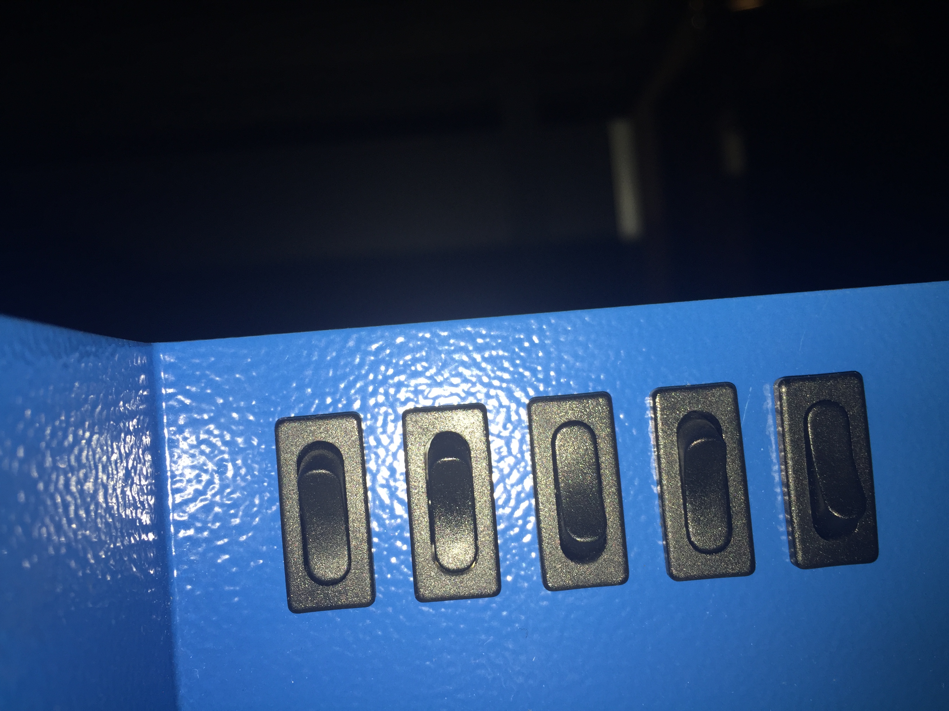

« Reply #271 on: February 01, 2016, 02:05:59 pm »
No, down is always On.
Seen from the outside to inside:
1. Display.
2. Power to DAC section (unrelated to power supplies and USB).
3. (ground) connected.
4. DC Offset Check (metering in the left leg). Needs 9V battery to be connected.
5. 705600/768000 input. Windows only and when player supports it (XXHighEnd, HQPlayer).
I've always trouble to memorize these buttons!  wacko bzz wacko bzz wacko bzz

Attached is a picture of the switches. Is this the correct position of sw#3 after isolation? Switch #1 is on the right of the picture.
Should I expect change in DC offset values from the std values.
« Reply #273 on: February 01, 2016, 03:07:54 pm »
Hahaha !
A bit hard to see in this large picture, but nice photo !
So your #3 is Down, meaning On, meaning ground wire is connected. This is NOT the idea with the NOS1a (however, everybody can decide for himself, of course). So with the NOS1a (not the NOS1) the ground wire better is not connected because now the isolation is complete. Thus, the "a" is isolated and with the wire connected, the connection is there again via the back door (the interlinks).
Thus, #3 should be Up for the "a".
That we also isolate the Silverstone is something else, but that is consistent with this.
That we next also use an Intona Isolator is unrelated (to above meant "consistency"), that is, as far as I can tell or thought about.
Ok ?
« Reply #274 on: February 01, 2016, 03:49:50 pm »
I will disconnect the black wire in the NOS 1a so will keep the #3 up ( not as in picture) & give it a go.
Meanwhile what changes should I expect in the DC offset values as compared to std values?
Thanks.
« Reply #275 on: February 01, 2016, 04:50:11 pm »
Sorry - forgot to answer that;
None.
neaneaneaneaneaneaneaneaneaneaneaneaneaneaneaneaneaneanea
That switch accomplishes that disconnect.
Up = Disconnect.
Down = Connect.
There is nothing else, except for that wire itself. Cut that and the switch is useless.
Clear now ?
haha
« Reply #276 on: February 01, 2016, 05:03:57 pm »
Thank you Peter. I am going ahead with the isolation at PC as well as the NOS 1a.
Let's hope it improves the SQ.
Cheers.
« Reply #277 on: February 01, 2016, 05:14:44 pm »
Arvind,
I read this again and suddenly it reads differently ...
I think I must apologise because you were proposing it correctly. It is just a langue matter ...
(and what I read in it at first, was that you also were going to cut the wire)
