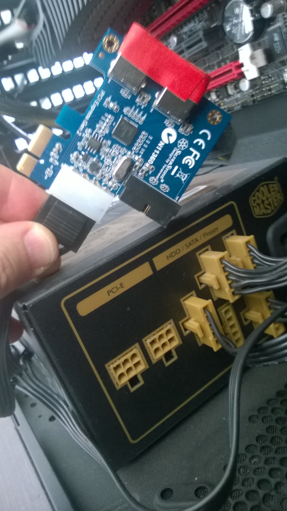

So far so good:
I installed the Silverstone without bracket.
Added some isolation tape around the USB sockets. See photo.
Silverstone worked with the first song, but after rebooting it lost connection with the NOS1, so I had to search my basement for a spare pc-cable. See photo.
Then I disconnected the earth cable inside the NOS1 and now it seems to work and play as it should.
Thanks for the help, guys!
And what about the sound quality?
It is faster and cleaner in a positive sense. I can play loader. Bass is very tight and detailed, but less prominent.
But I miss a little "ease" and natural flow. Maybe it can be re-gained with some other settings. This will require further listening. It's a pitty with all those screws on the NOS1 cabinet. A simple ground-lift switch on the DAC chassis would have been convenient.
PS: With the ground-lifted Silverstone setup the NOS1 sometimes disappears as the selected "device" in XX settings.

Be VERY careful with USB ground left lifted inside NOS1 and USB cable connecting other USB3 port (than Silverstone card).
Peter already warned on this situation - can lead to frying NOS1's USB receiver...
