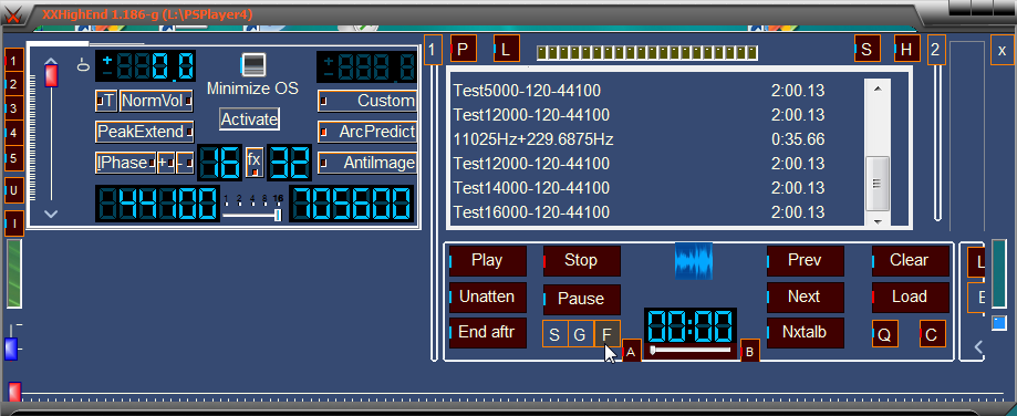

I found some 44/24.  It also multitasks.
This confirms that the lack of multitasking on AI is a 16 bit vs. 24 bit issue.
But not here. BUT :
While writing this, I suddenly recall that it works at the album level. So, load a Playlist with tracks from several albums and then it won't work (and never will - just saying).
So that will be it.
charliemb
Posts: 278
« Reply #70 on: June 24, 2014, 05:57:05 pm »
Can't this be the difference between WAV (not) and FLAC (does) ?
Uh oh...  I think it could be.  I will confirm tonight.
But I hope not because most of my CD collection is ripped to AIF using dbPowerAmp, AIF being like WAV.
July 2019:
« Reply #71 on: June 24, 2014, 06:00:47 pm »
No no, WAV and FLAC both work. AIF(F) will too (not that I tested that).
On another note I used that AI version myself for a couple of weeks and if it would have not used multithreading I would have known. This with the notice that I used it with upsampling ti 705600 and a 430MHz set processor ...
« Reply #72 on: June 24, 2014, 06:16:24 pm »
See New Filter request(s) - XXHighEnd 1.186-g for the original text coming along with the Filter Beta.
Unzip the 4 files in the download (at the bottom) over your current 1.186 or higher folder after removing XXEngine3, XXHighEnd and AutoHotkey from memory.
This solves the ticks.
With thanks to those who noticed it was in the right channel only (now it took me minutes only to find the culprit).
24 bit "DAC Needs" noise takes more time to solve (so later) but it won't play now with the Custom Filter engaged.
Once more apologies that this could happen (but I guess that's beta-beta).
Edit : Download once again removed. sorry
