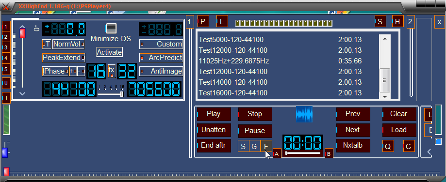

Anyway, see beta-beta download below;
You will see quite some improvements for the AI filter which even to my ears is listenable but which I gave up upon because of it's (still) akward-ish usage, plus no real solution in the end. Nice for the Frequency Domain, but that is really all and it will never serve the Time Domain.
So (and already talked about I think), in there there's also a "Custom" filter, and *that*'s what the sh*t is all about. Next small problem (no, same problem) : although that works perfectly all right for the NOS1(a) it can not work the very best for 176.4/192 only (44.1/48 upsampled). This is just too low to avoid images in the audio band (and the Anti Image filter does not).
Still I made one for you (or anyone else with 192 max capabilities) so you can try. And it should at least work way better than normal Arc Prediction. It still does not ring a bit, and "utilizes" the frequencies we won't perceive anyway, assumed we are old enough to begin with. Just as you asked for (the new AI filter in its default settings does that too but keeps on ringing, but less now).
For NOS1(a) users ... they too can try the AI filter of course, but they for sure should try the "Preferred" 705600 Custom filter (you will understand when using it). I am using that myself for maybe 6 weeks now, and I don't think I will go back. Improving it yes, but I never spent a second on it after this first attempt.
People should notice that the Custom filter's name is exactly that : ready for you to set in all directions. But back to the beginning of this post - you won't be able to see what you do, and it's really "no task" to start dialling without analyser (or well done emulation of which I think it is not possible).
So what I'm saying is that he "customizing" will be for myself for now, and Pre-selections will emerge from it. Just like how it is now (with actually one setting in there at this moment).
The settings are envoked by means of the [ F ] button you see below (see mouse arrow) and the Custom Filter is engaged by means of the "Custom" button above "ArcPredict" (top left section). Don't forget to click the Help link in the settngs screen.
The download at the bottom contains 4 files. Unzip them over your current 1.186 or higher folder and nothing else (!). Before doing so, kill XXEngine3, XXHighEnd and AutoHotkey from memory.
Important : This version will not allow you to go back to the ever existing version of AI filtering; for that you'd need to revert to your current XXHighEnd.exe and XXEngine3.exe. So set those aside when you think you want to compare.
The 1.186-g you will see is just the latest version but no Release Notes. All I can say is that it may be quite useful for (tablet) remote operation (since I started to use that exclusively myself again, haha).
For all who try this for the filter, let me know your findings !
EDIT : At this moment it appears so that the Custom Filter does NOT work for "DAC Needs" = 24 (bits).
This is not sorted out yet, but take it this implies static (loud noise). See posts below.
Edit June 24 : Removed the download because of a few issues. A new download (1.186-h) will emerge in this topic soon.
