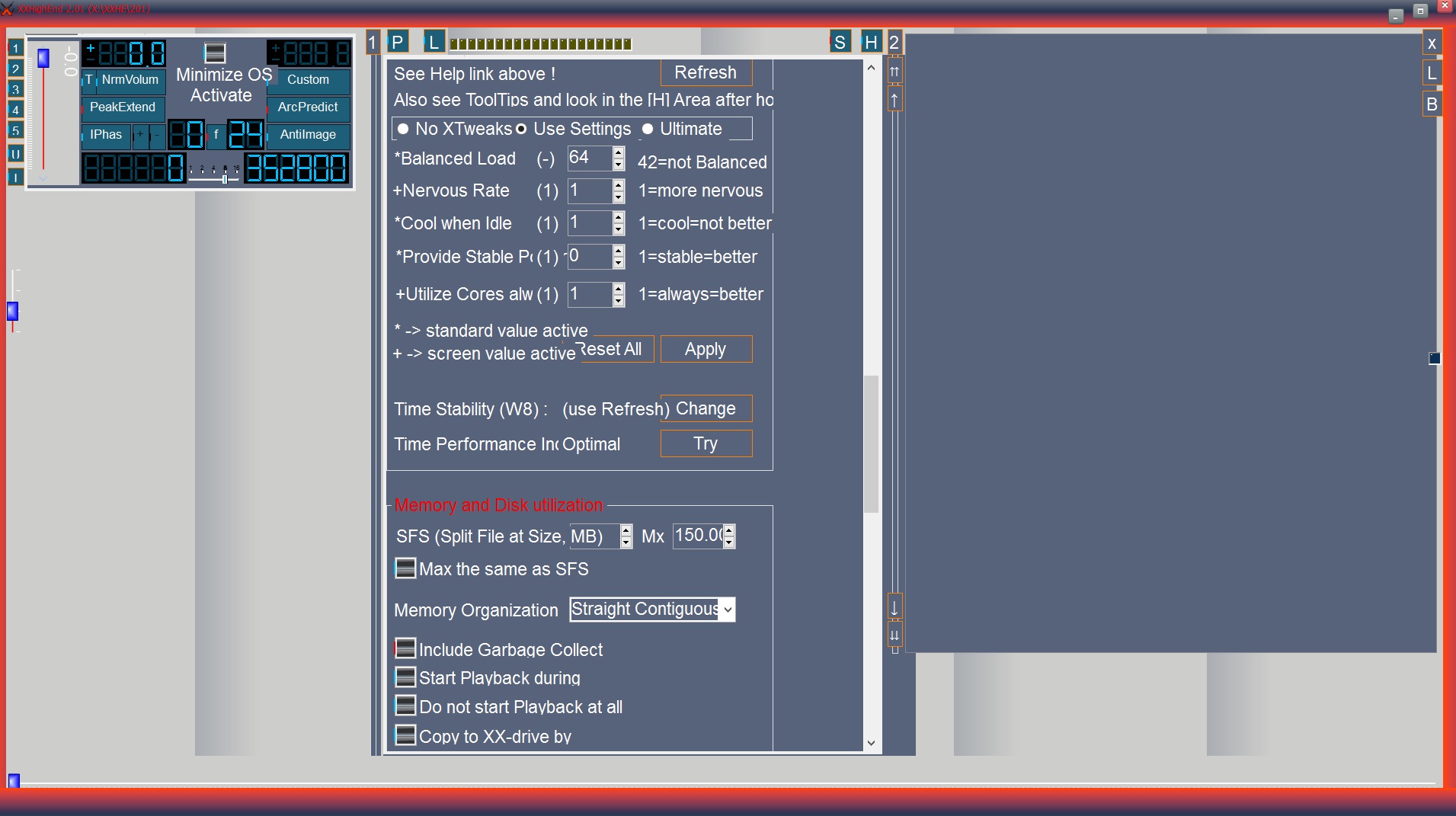

Since I have larger fonts set, the UI is pretty bad, with text overrunning many fields.  I will have to adjust that.
Hi Jud, can you show me a picture of that ?

« Reply #12 on: June 03, 2015, 06:24:00 pm »
XXHE screenshot attached.
« Reply #13 on: June 03, 2015, 06:51:53 pm »
Ah ...
What about setting the Scaling smaller ?
If you set ity to 1.7 it will be the same as it was (1.186).
Jud
Posts: 292
« Reply #14 on: June 03, 2015, 06:54:54 pm »
Ah ...
Will that affect Remote, or different settings?
