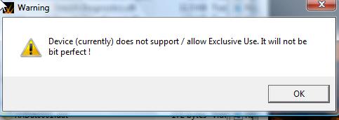

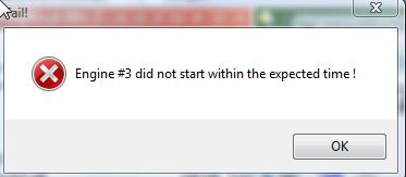

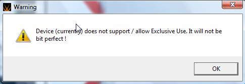

I installed 09Uo and get the following messages, no sound.:
The last picture shows the settings.

« Reply #1 on: February 17, 2008, 08:33:09 am »
GerardA,
To be sure : I recall you could play before ? IOW, what worked before now doesn't ?
Or are you trying something else now ?
Did you try the normal 44.1/16 setting ?
« Reply #2 on: February 17, 2008, 12:33:06 pm »
Before I could play with engine 3 and only got the message about exclusive mode.
After I instaalled 9u0 I get these messages for all the settings I tried.
If I change samplerate to something else than 44.1 I get an extra message about a wrong samplerate,
so that's not the problem I think.
The first message I showed I get too when I change the volumesetting.
BTW When I clear the playlist one song remains and I can not get it out in any way...

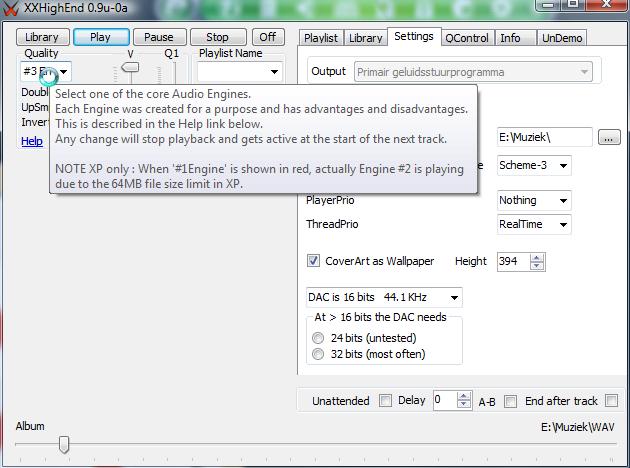

« Reply #7 on: February 17, 2008, 01:56:06 pm »
Eureka!
I get music now.
I changed the setting to "DAC is 16 bits 44.1kHz" and I get some messages (see below) and the music starts to play. If I set the setting to 24/192 the problem as reported before happens again.
As you can see there are now less messages.
I don't know if the sound is better this way?
I can not hear it now, vacuum cleaner, hairdryer and two crying/playing children (those sundays are good for family life  Happy)

« Reply #8 on: February 17, 2008, 02:08:57 pm »
Ok, this is what I expected. Now you only don't "need" those messages. BUT : they will stay in, because actually you want Exclusive Mode.
Now on this point currently I'm lost, because there would be no real reason that I know of that Exclusive Mode is not allowed, while Shared Mode is. The only thing which might help is the information on what Shared Mode actually uses. The big point is : it should be using the data in that 2|16|44100|176400|4 message, which just is the right data. If you have any means to check it, ... please tell me.
At this point you should try a native 96/24 file (buy one from Linn for a few euri if you don't have any) and let me know what happens.
If this works in Exclusive Mode I'd know that there must be some setting I can emulate (which would come down to Doubling and 16 to 24 which is *not* in there yet).

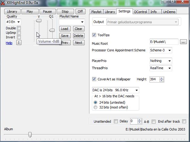

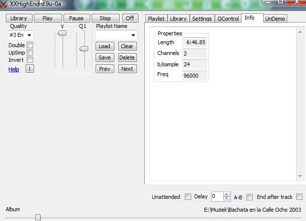

« Reply #9 on: February 17, 2008, 02:55:19 pm »
No change, 96/24 gives the same messages, with other numbers.

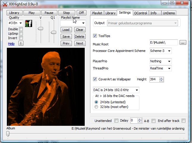

« Reply #10 on: February 17, 2008, 02:59:28 pm »
Heee,
I changed the setting to 32 bits (most often) and got some new messages and it started to play.
After stop and play it started to play without messages!!!!!
Keep my fingers crossed!
And the volumecontrol of the laptop has no effect so this must be exclusive mode  good
With 16bit/44kHz I can not choose the 32 bit option, with 24/96 it is possible, maybe a small change for this?
